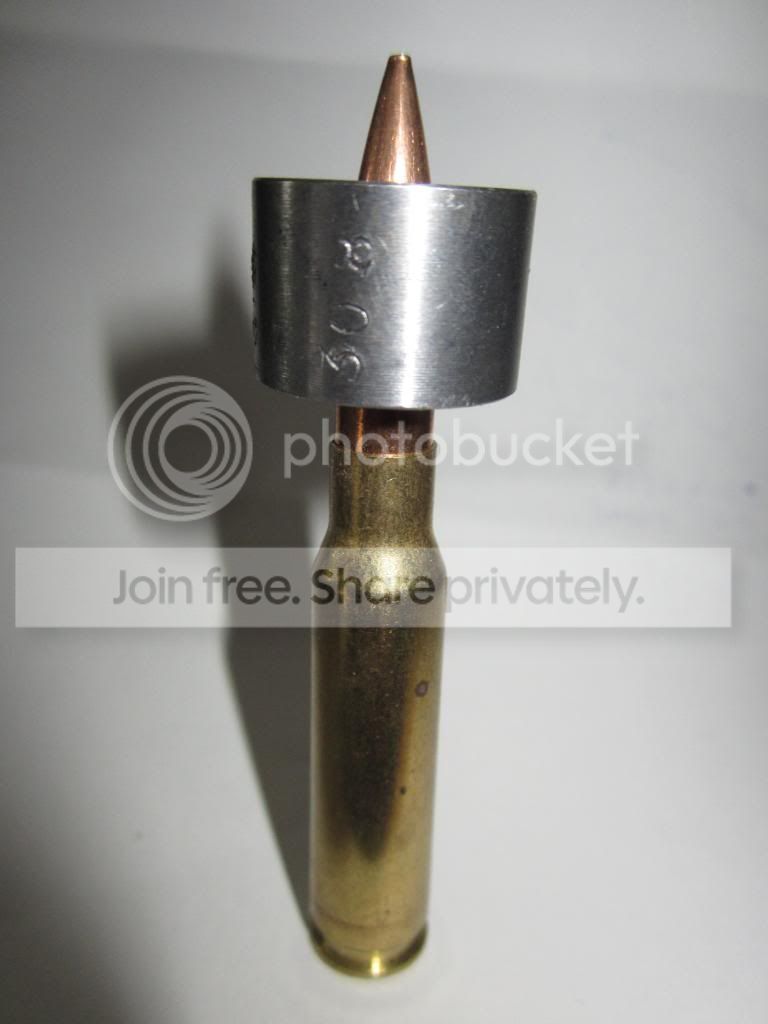

If you want to measure how consistent your seating depth, you need to put a collar on the round that sits down on the bullet shoulder. I use one because it allows me to switch bullets and come up with a new OAL for the new bullet that gives me the distance from the rifling I want.
I make my tool from a piece of barrel that has been touched with the throating reamer, so it replicates the throat of the rifle. It sits on the shoulder (ogive) of a VLD or a round nose bullet and allows me to measure from the top of the collar to the base of the case so I can load any bullet to the "jump" I want.
