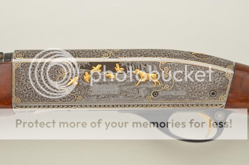

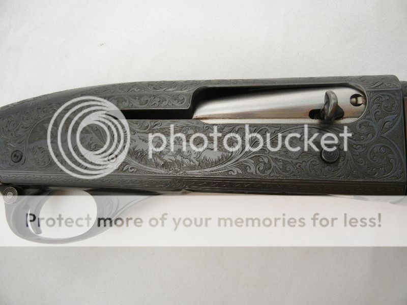

Any guns that are non-machine engraved will be worth a premium. This holds true of basically any maker, not just Remington. There is nothing like the beauty of a hand-engraved firearm (assuming the artist was a capable fellow!).

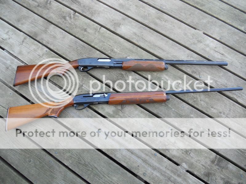

I know I have one 1950 for sure and something tells me I have another in skeet I picked up from madtrapper. Maybe he would remember since I'll be dammed if I am going to take off a pile of gun socks to find it
Did you pick up any more of the 3 1/2 wingmaster. I remember you got one
That was the one I got from trapper, early version for sure
Cheers
Nice pair .I am still looking for a 3.5 inch wing master. Dutch
I would say state side would be the only place now unless you get super lucky. I preordered mine when I heard they were coming out in 2001 or 2002 I forget and I think they brought 6 in there. I know VLT79 got one but I think it was state side but could be wrong
The bottom 1100 16ga was sold back to it's original owner since he wanted it back and I had four 16ga 1100 , three of which were just being safe queens. Nice to see she is back in action at the duck ponds

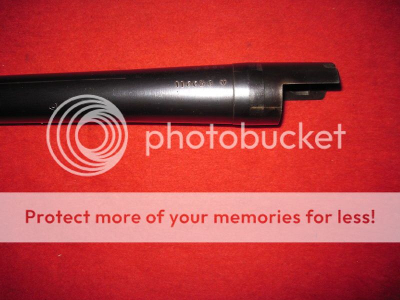

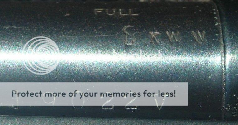

Look at the serial number of this barrel meaning how many were made previously
KWW is may 1950 to me

Can you guys please share a pic of one of these 870 banded barrels. I would love to see one since I never have in my travels with 870's unless I call it something different
Cheers
One like this maybe??
