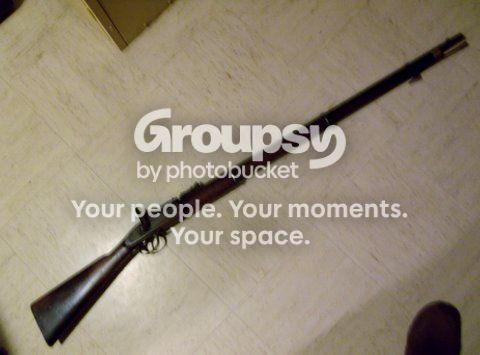

SNIDER MK II** LONG RIFLE
This Example Lock Plate Date: 18
Manufacturer (s): B.S.A. L.S.A., Enfield
Bands: 3
Furniture: Brass
Hammer Face: Cupped
Sights: 950 yards
Barrel Length: 36.5"
Overall Length: 54.25"
Weight: Lbs
Bore: .577
Rifling: 3 groove
Notes:

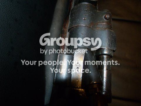

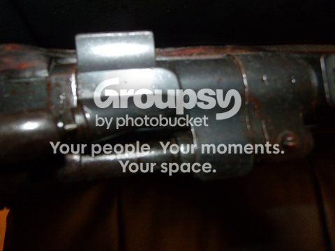

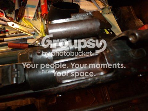

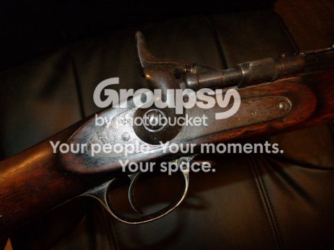

This is the most commonly encountered Snider rifle and was improved in five ways from the MKI* and the MkII*:
1. This was the fist Snider to have a cupped hammer
2. The firing pin nipple was slightly shortened
3. Reshaping of the extractor
4. breach block face enlarged
5. shoe altered in respect of he above alteration
If the original cleaning rod is sill present this will have a squared jag, with a reduced diameter - most however were replaced with later roundheads, as with the original P53.

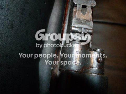

The breach is simply marked with II**, denoting the arm mark...Finally no MkII model rifles were produced.
