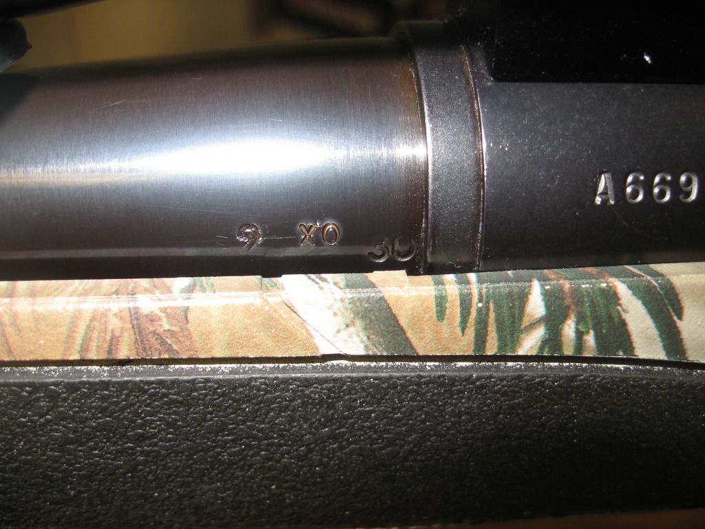

Hope this works. Don't mind the stock! I hid the BDL stock away for safe keeping. The rifle is a shooter not NIB what-so-ever.
[/URL][/IMG]
This pic shows the build date. X is December, Q is 1978. It is the latest serial number and only December built one that I know of. All others I've seen documented were assembled in November of '78 for the '79 calendar year sales.
As far as I know if was just a screw up by someone at Remington who didn't really know the difference between the .280 Remington and a 7mm 06. They were in an advertising phase trying to increase interest in the old .280... the 7mm 06 was chambered exactly the same as the .280 Remington, it does not have the chamber dimensions of a 7mm 06.

Wasn't really a screw up. When the name change was suggested to bring new life to the cartridge, 7mm-06Rem was chosen but later retracted, as stated above, but some of the rifles had received the -06 roll mark. They were mistakenly shipped and recalled. Some came back and were re-barreled to 7mmExpRem. This, I believe, is why some ExpRems are serial numbered earlier than some of the -06s, unless the two roll marks were used at the same time!

According to several different (internet) sources, there was a run of 200 made in 1978 prior to the 7mm express debut, most were shipped to gun writers of the day. They promptly recalled them once they realized people may actually try and shoot 7mm-06 rounds in them. Apparently 160 made it back to the factory.
