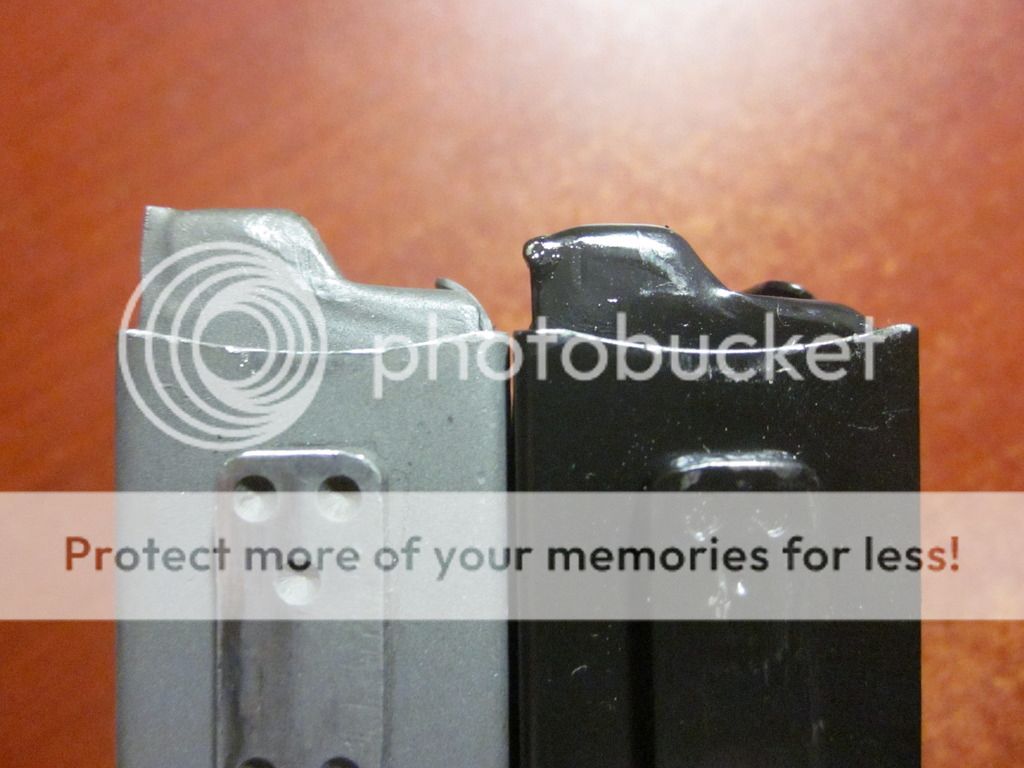

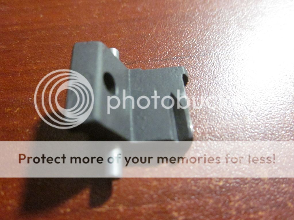

Seeking the expert opinion of the M14 gurus we have here, or anyone with experience with the SEI Extended Bolt Release. I received and installed one on my Norc M305, but testing it's function has revealed some issues. To wit: the bolt hold open doesn't work with three magazines I bought from MagWedge. When I remove an empty mag, the bolt slams home. It does seem to function (in the limited testing I did) with the 2 Norc mags I have.

1. I observed the MagWedge mags compared to the Norc, and I notice the follower on the former does not protrude quite as high in the back left portion (part that interacts with the bolt stop) as it does on the latter. I believe this part of the follower is not lifting the bolt stop/release high enough to interface with the bolt. It is probably worth noting that the factory bolt stop worked fine with all my mags.
2. The SEI bolt release came with a roll pin that it rides rather stiffly on. I tried the original Norc pin as well, same outcome. By stiffly, I mean that the bolt release doesn't move under the spring pressure of the bolt stop. And in fact takes more force then I would think necessary to engage. I wonder if this too isn't a factor in causing the release to fail to engage the bolt.
So, my questions I guess are: Can the bolt stop be modified in anyway to ensure it will function with all my mags? I'm thinking bore out the hole the roll pin goes through, and/or build up the bottom surface that interacts with the mag followers with JB Weld or something? Additionally, has anyone used the MagWedge extended bolt release and encountered the same problem?

Edit: So after a lot of playing around, swapping parts, taking measurements, not to mention more help than I deserve from Dave at MagWedge, I determined this was a magazine follower issue. Neither the SEI nor the MagWedge bolt release was the issue. Additionally, it was not the MagWedge purchased magazines either, but an out of spec follower. Thank you Dave for helping me out with this. Thanks also to everyone who offered suggestions, as they did help with the proper function of these parts.
