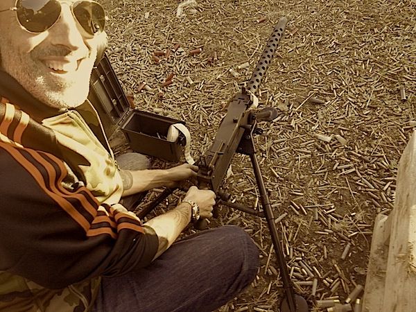

A bit of Newbie 1919 excitement I wanted to share. Any resemblance? Lol
Would also like to thank you all for the help and support so far. Much respect!
Never thought I'd get such a perma-smile shooting this thing!!! :d
