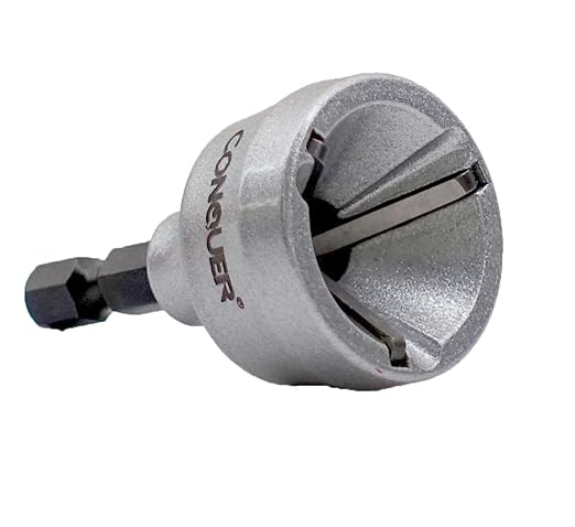

I have been so frustrated with the poor quality of the neck deburr tools offered to hand loaders and now I've found some products that work very well on Amazon.

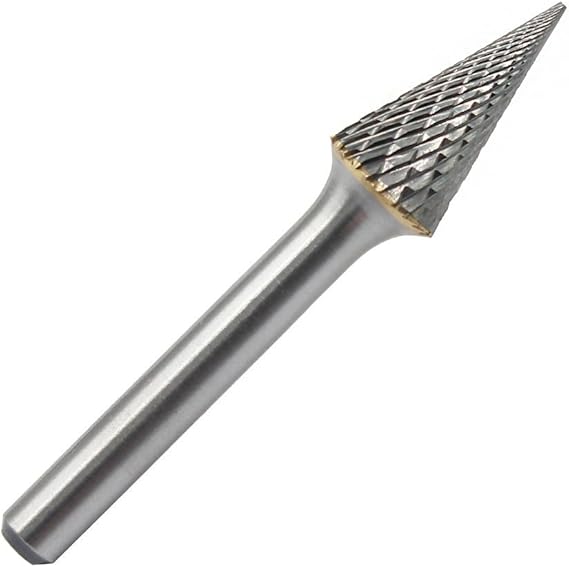

Get the 1/8"-3/4"... Now I don't see it shown any more, but I got the one with tungsten blades.
There are others if you shop around for better pricing, but I really like the carbide one.
Also pay attention to the angle, you don't want one on too soft an angle.
https://www.amazon.ca/dp/B09PXVQXMJ?ref=ppx_yo2ov_dt_b_product_details&th=1
For accuracy I find that a really soft angled chamfer on the inside of the neck really helps get the bullet started when seating.
https://www.amazon.ca/YUFUTOL-Tungsten-Carbide-Pointed-2Cutter/dp/B07C1KRGXR/ref=sr_1_53?crid=38XV8T7MLXBH3&keywords=carbide+burr+1%2F4+cone&qid=1675463763&sprefix=carbide+burr+1%2F4+cone%2Caps%2C84&sr=8-53

The outside one is expensive if you don't use it much but does fit in a drill but the inside burrs are cheap and I own already so its a plus.

One like it just happens to be on sale at Princess Auto, and includes the ID as well as the OD pieces.
Sale goes until Feb. 12/23

I used the RCBS double ended tool for many, many years, then switched to a nice Lyman inside reamer and used it for a few years. Today, I stopped in at Princess Auto in Regina and bought the set pictured above. I have two battery drills that are pretty much useless, so I'll leave them in my playhouse office where I do my reloading. I'll put the reamers in the drills and leave them near the charger. :d
