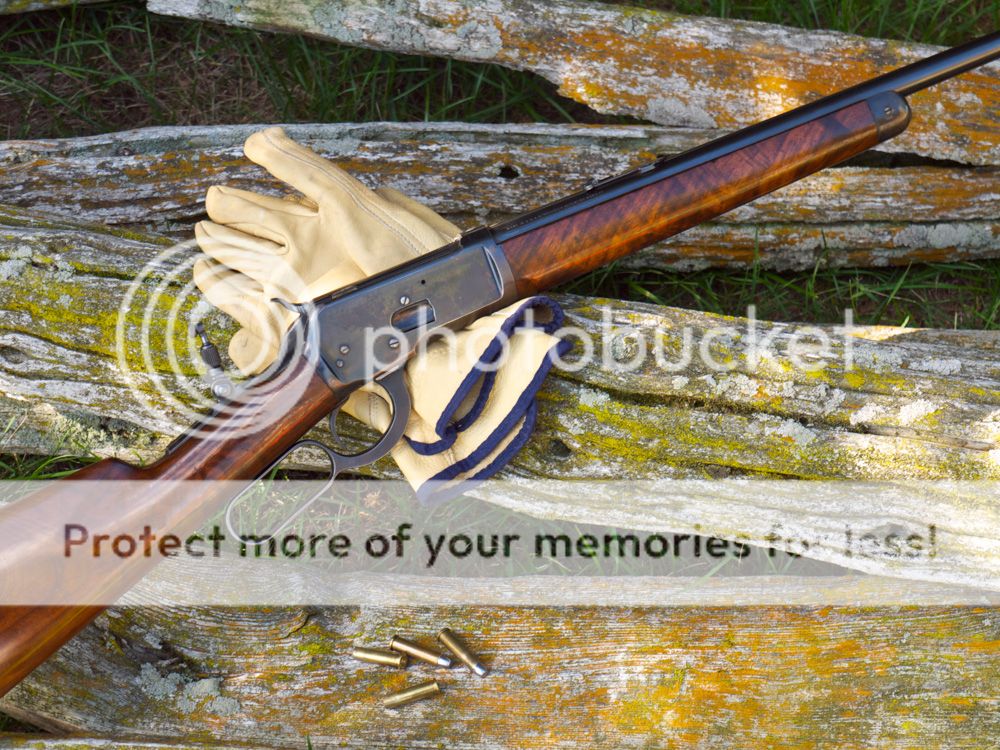

I have been trying a wide variety of powders and loads over the past couple years, to see which gave me the best accuracy with my Accurate Moulds 312112M plain base, cast bullet. Note: if you order this mould, crimping in the groove means that you will be levering the bullet into the lands, which puts too much strain on the levering mechanism for my money. I use a Lee Factory Crimp and set the bullet in just enough to not quite touch the lands, and crimp it there on the forward driving band. Powders ranged from Unique on the fast end to IMR 4198 on the slow end. Finally, I laid all the targets out on my pool table and made my selection ... 9.5 grains of 5744 with a small pistol primer, for a velocity of 1,230 fps and an E.S. of around 7 fps in 10 shots. At 25 yards, a 3-shot group is about 3/8" (which is the average range I deal with varmints). At 50 yards, a 5-shot group is roughly 1", and at 100 yards, the 5-shot groups are around 2 & 5/8".
Photo of my Winchester Model 53 made in 1929 in 32-20 caliber (32 W.C.F.) ....
