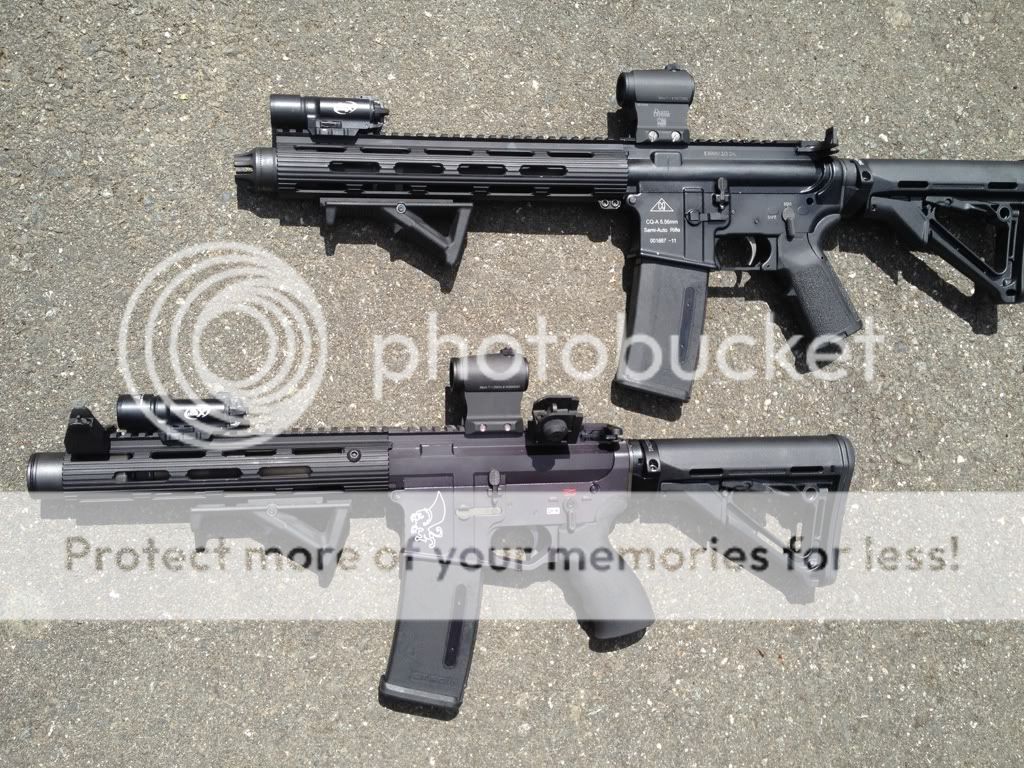

I also have a Nork 10.5 and an NEA 7.5.. So far they have given me 0 issues..fun little rifles..
I have owned mutiple dozens of AR's with barrels ranging from 7.5 to 14.5 inches in length. All have been reliable. Short AR's are fun! Stop talking about it and get yourself one!
