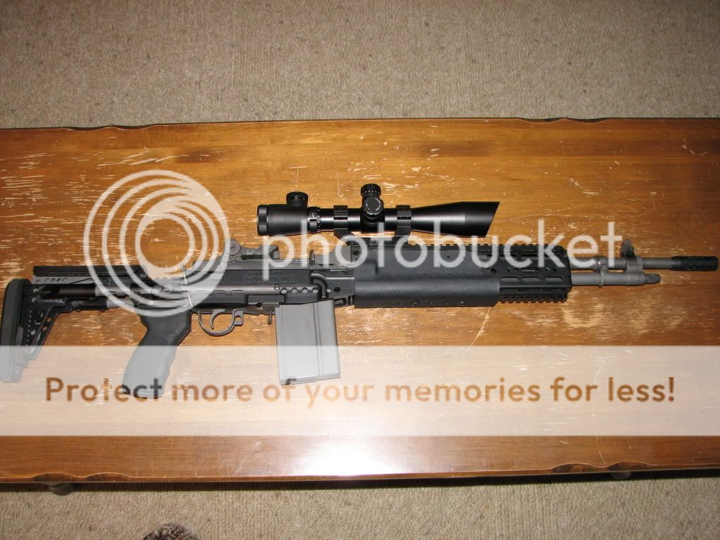

I got a couple Millett DMS scopes recently and a set of UTG quick detach rings ... so I put them on my M14's ... the shorty will eventually be put in my McMillan folder stock once I get some bedding done.
