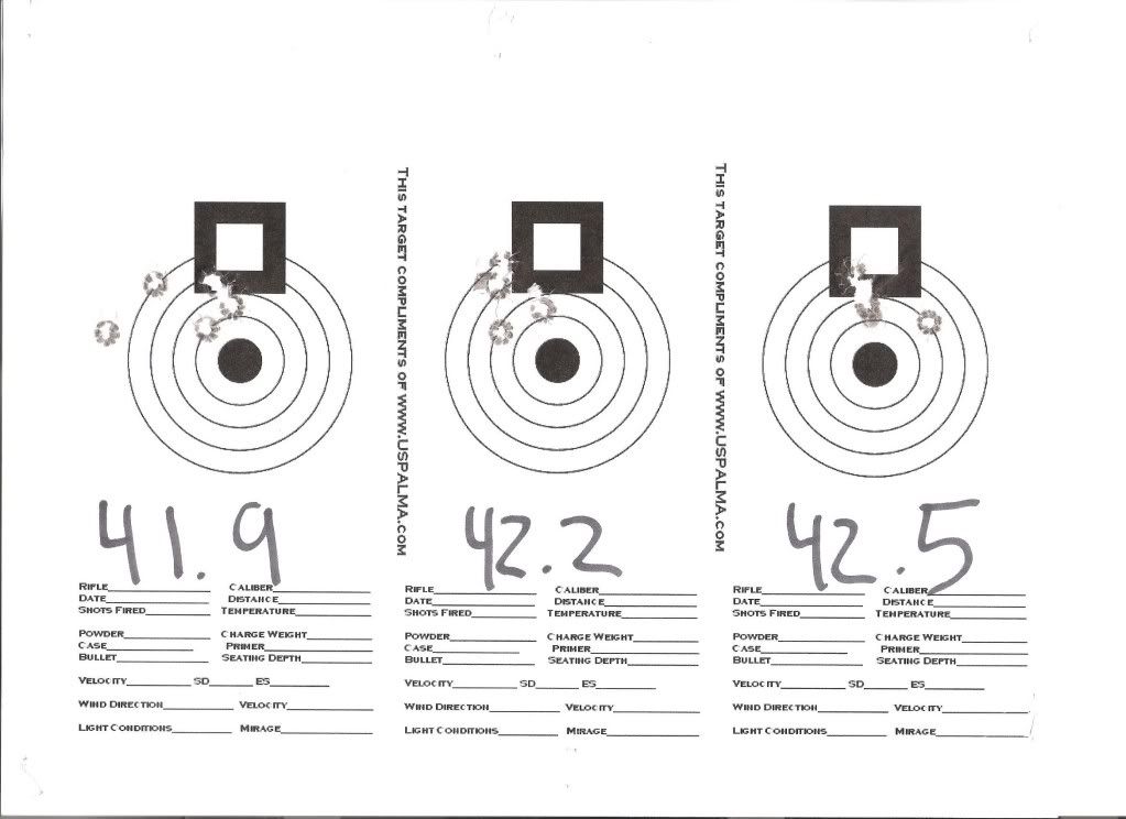

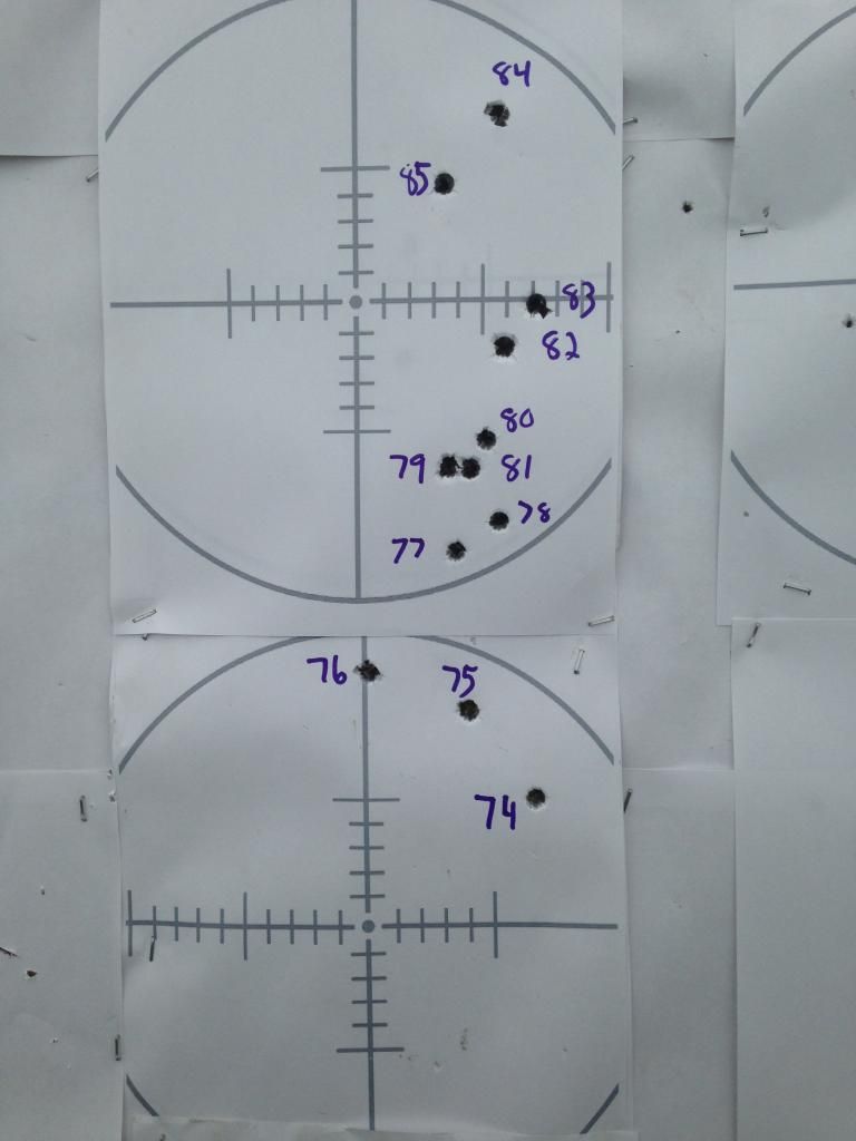

This is a ladder test on what I later discovered to be a poor barrel, the benefit is I didn't go chasing 5 shot groups, that would have been a lot of wasted powder, the spread of these shots is a very clear indicator of something not right, I could not duplicate any results resulting in scrapping the barrel.It does show some clusters but again, could not be duplicated.
This is a ladder test with the new barrel ,this shows a major improvement in over all cluster and small clusters , excellent starting point.Same distance as other ladder test.

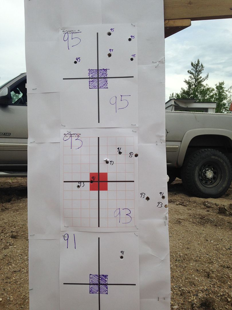

Even though the top powder has a phenomenal 3 shot group I chose to pursue the second powder as the overall group to me was less sporadic, which to me was more important due to the fact that it would be less effected by changes(temp, environmental, clean/dirty) , in other words to me it was a more harmonious powder to use.
After this I moved out to 500 as I really felt I had the combination I required so I moved on and tested some groups, as I felt I had a node in the higher end and no pressure signs I upped my charge weight on the top end and tested...
At this distance you can really tell where the rubber meets the road, starts to determine where the accuracy really lies as close up may look alright but start stretching it out, those little differences really become apparent.

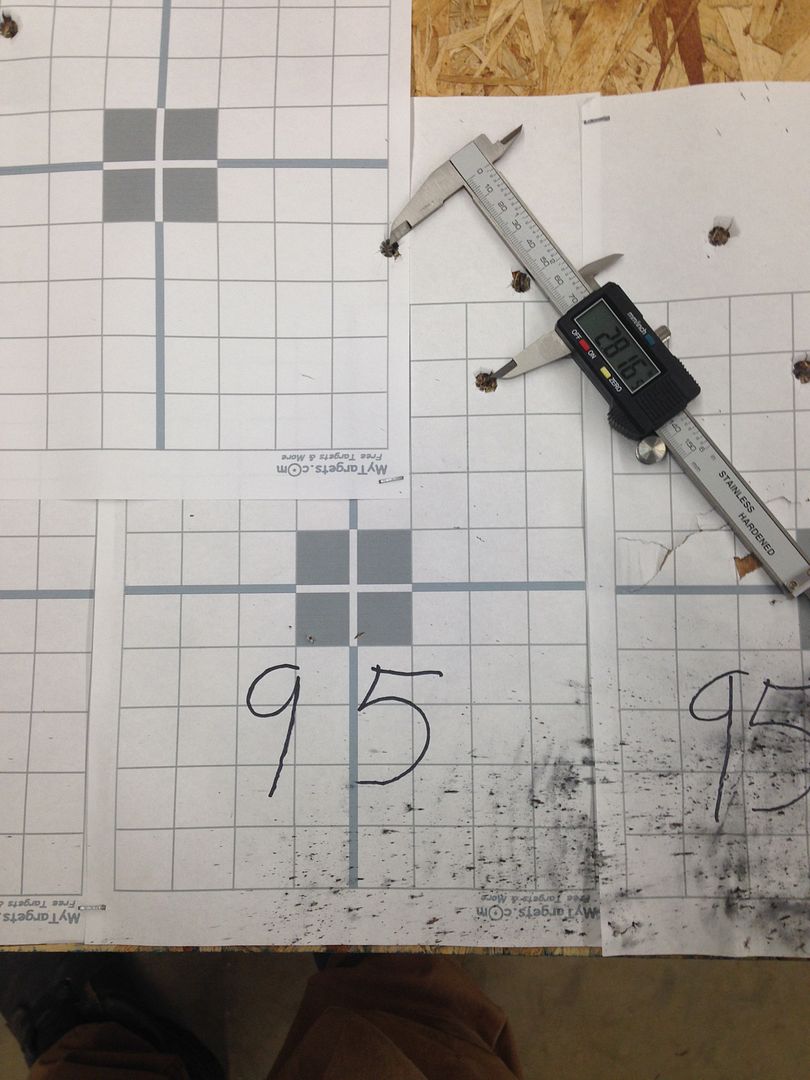

I then did some three shot groups in smaller increments, almost duplicated the group size...
This was a good example to me of it working correctly, using minimal components.
IMO recording the charge weight next to the hole makes interpretation a tad easier to find your nodes and go back and forth between targets.A chronograph isn't necessary but it does help.

Learn to read and feel the groups, take note of the shots you feel you may have pulled , this helps . my 95gr target shows such a shot which I discounted then confirmed later with one more test.I will stretch out to 1,000 and may or may not play with seating depth as I feel the accuracy achieved now is what I want.

This ladder test is a dud. No offence intended but you might not be skilled enough yet for such a test, or perhaps the gear is not up to snuff.
Unfortunately the photo given doesn't provide anything for scale except the bullet holes themselves, but it looks to me like this 10-shot group at 300m measures about 130mm extreme spread, that's a 1.5 MOA group. The group formed by loads 4-5-6-7-8-9 looks to be sub-MOA. This is with cartridges with varied powder charges! This is not poor shooting, nor is it a substandard rig. If nothing else I say this ladder test suggests you are going to be able to throw together almost any load in this range and expect very accurate ammunition.
Looking at op's photo, the ratio of horizontal variation to vertical suggests to me that I can't trust the variation in vertical is actually due to barrel harmonics causing clustering, or just variability in gun/shooter/ammo which is what a ladder test is for. This is a low confidence result. Having a sub moa cluster, in a more or less circular pattern tells me something is wrong. Could be the shooter. Could be the ammo, could be the gear.

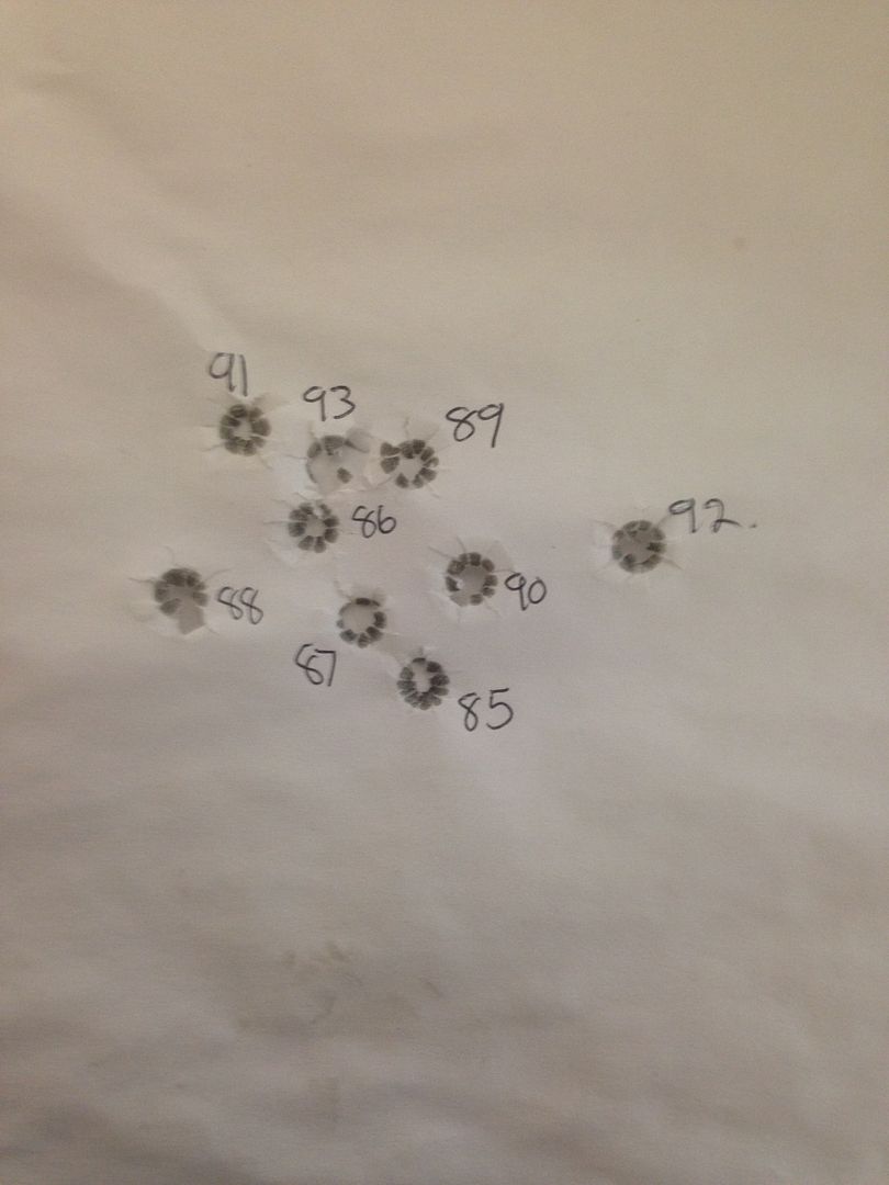

Alright , so how would you interpret these two ladder tests?
This one sure shows some nice vertical with clustering.
This one , obviously shooting for a group? No?

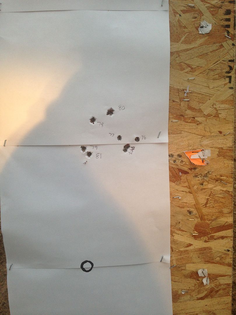

This one I shot a few weeks ago. Not a "optimum" result, even at 500m, but the node is quite clear (10-16)
Here is a better one at 300yds. Still some strange movement, but the node is also clear (11-15)

I think that some believe that a barrel only moves up and down during the whipping process , IMO it does like flat "s" or squiggly type pattern kind of.
To me it is shown in group testing as they move on two axis not just one.
I have had more exaggerated results but this is all I have a photo of, not only a tighenting of the group but vertical and horizontal movement.
SO a ladder test to me having horizontal deviation is part of the process, especially going from below minimum up to your maximum charge.A lot can take place in the spread, which a ladder shows much easier and with less bullets wasted.
