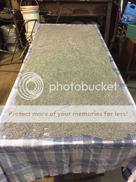

I did a larger run of shot today, I'm not sure how many pounds. I tried mixing wheel weights with range scrap 50-50 and results were decent. The shot is not quite as round as pure wheel weight but I think it will do for shooting clays. I will have to pattern both and see if there is any difference with the 50-50 blend as it will be lower BHN.

Another short video with the funnel added and a pic of the shot I made in about 3hrs.
COWW is known to be the best alloy for making shot. Beside the fact that has the right amount of lead/antimony/tin it has another very important component that shot needs. And I'm talking about arsenic. Without going into deep metallurgical philosophy, COWW is the best alloy for making shot. Period.
But as overunder725 said, decent shot for free is better than perfect shot at 50$/bag. Is that a funnel or a plunger?
