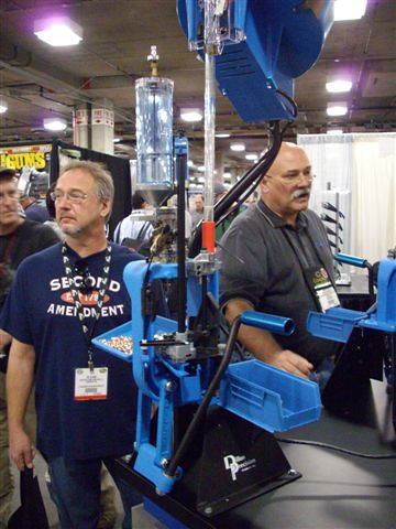

The good folks with the blue presses tell me they have nothing really new for 2011, so I grabbed a fe pics from their booth for your enjoyment.

Never going to happen. The minute Dillon starts shipping a case feeder, they say they have to deal with ITAR and State Department headaches. As it is now, they make hobbyist equipment and seem determined to remain as such.
Case feeder's not an issue - a bullet feeder would be t*ts. I've seen the GSI and the RCBS, I think Dillon should just buy the GSI design - very nicely integrated into the press. Definitely looking at getting a 650 this year.
The GSI is an over engineered piece of ####. If Dillon starts shipping them with presses...I may have to buy a Lee :runaway:
Dillon really needs to address a few issues with the new 1050s and that stupid link arm. As well they should consider a new press altogether. something with more stations, and more options, before and after the powder hopper. a better primer feed system would be nice too. a twelve or 14 position toolhead would be perfect. and whoever comes out with one, so long as it's quality, is going to take a lot of business from Dillon.

I'm with you on this one. I'm not sure if I need 12 stations but I could use a couple more on the 1050.
Bullet feeder
Full length resize
Powder check
etc.

Well, I could use an extra few holes on my 1050, thats for sure. Trim die, powder check, bullet feeder, to name a few.
