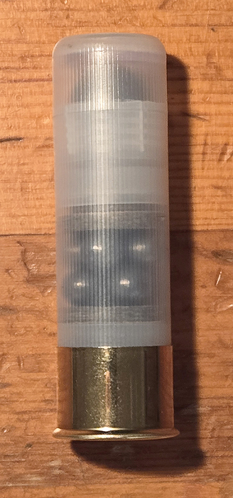

Ohhhhh .... you mean something like this?
  • 58cal round ball and 8 x #1 buckshot pellets.
Now is this considered buckshot?
Because I can hit a 9" paper plate with this load at 50 meters (with the 58 cal ball) ...... and with my 870 and a .680 choke .... :D
BC defines shot as 8 or more roughly spherical pellets and for Deer, Black Bear, Cougar, Wolf, Wolverine, Lynx and Bobcat the pelleta must be #1 Buck or larger. No where that I see does it say they have to be equal size only "roughly spherical"
