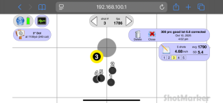

Shotmarkers up and running at our range
It'd get a lot more expensive if anyone shot the system parts. You must have a range membership of competent shooters who can trust each other not to be stupid.
Nice upgrade, are they left out or set up each time? Is their use limited to certain members or all members? Trying to understand how damage is monitored and who pays when they explode from an errant shot!
The units are taken in after each session, but the frames stay up. It takes less than three minutes to set up each one .
Only the RSO's have access to the units , we put a notice on our calender and on our long range shooters facebook page when an RSO is going to be setting them up.
The microphones are quite a distance apart - 80" or so .
If a shooter is inexperienced at long range shooting, we get them to put a couple of shots onto the steel at the distance they are shooting , to verify their zero.
