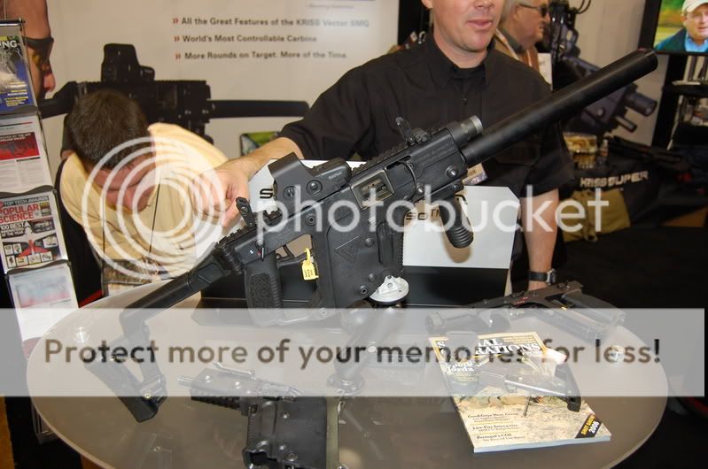

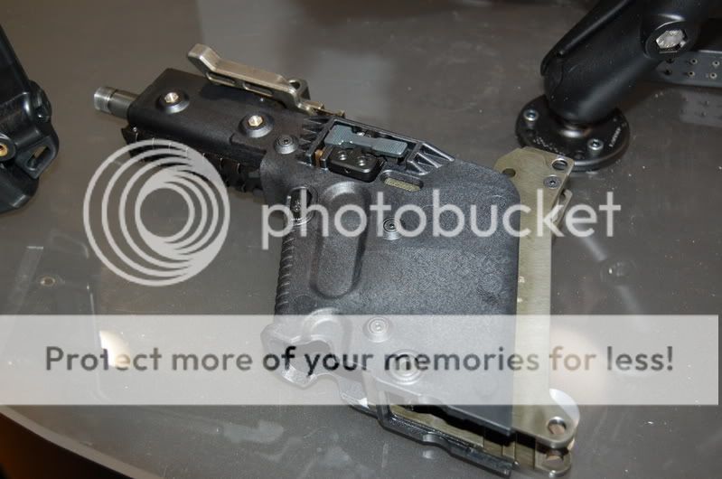

Just a few more Kriss images.

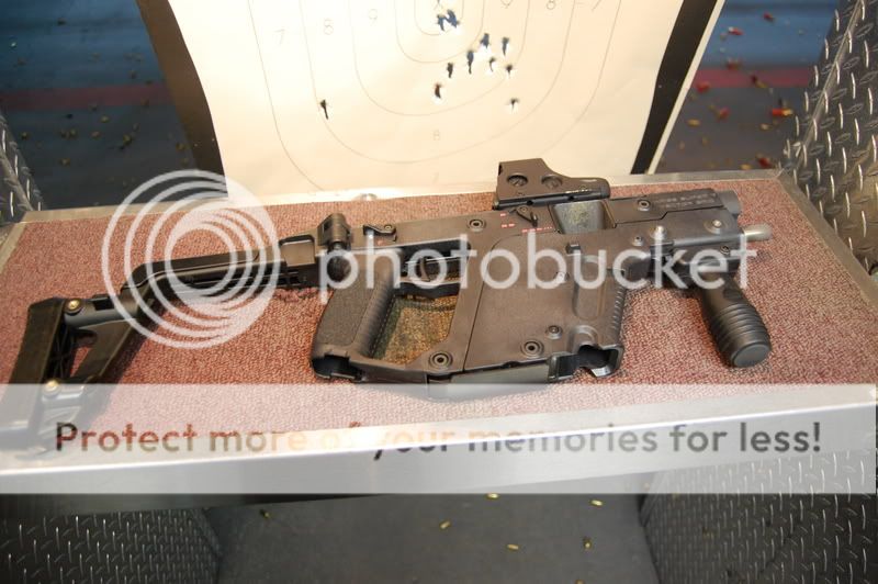

Showing the new 16" Carbine version that is geared towards civvie sales (note the absence of the fire selector and the ability to wire internally a pressure switch activated built-in light or laser). On the pedestal's top you can see the upper and lower halves of the SMG version with the buffer off to a side.

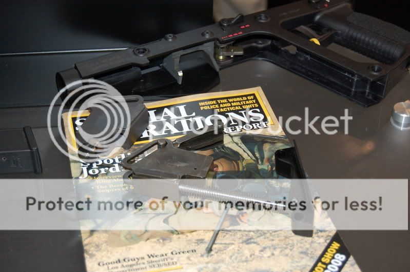

Here is the lower, you can see the complex looking bolt/slide release. As well as the actually decent folding cocking handle (press check when extended outwards)
The upper of the SMG and you can barely see the mechanisms of the selector there. also shown are the bolt and the buffer w/linkage. Notice the huge case deflector is mounted by external screws and rests inside the upper. The rear mounted safety completely blocks trigger travel (on the sample gun the safety needed to be 100% in the F position for ANY trigger movement. No 90% or 95% at the F position. A slightly felt detent did hold the safety in place through single/burst/FA action.
At the Gun Store with the provided Kriss and several mags of ammo later. Showing in the background is the results of the 2 round burst. (One flyer from the single shot cam response I mentioned earlier). Note the brass marks on the EoTech which is not good IMHO. While EoTech's are designed for ruggedness, repeatedly hitting it with hundreds and hundreds of brass cannot be good for a consistent zero. It made me think that they need to increase the size of the existing deflector or remachine it with a steeper slope nearer to the top edge. On the stock you can see to gold coloured inserts which hold set screws for the LoP adjustment on the shoulder pad.
