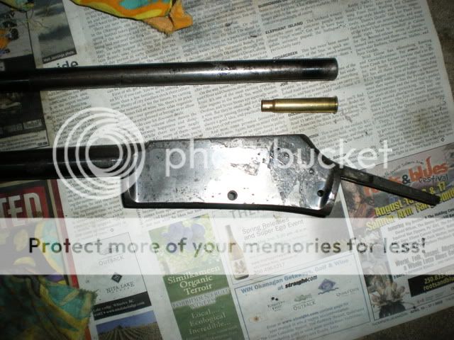

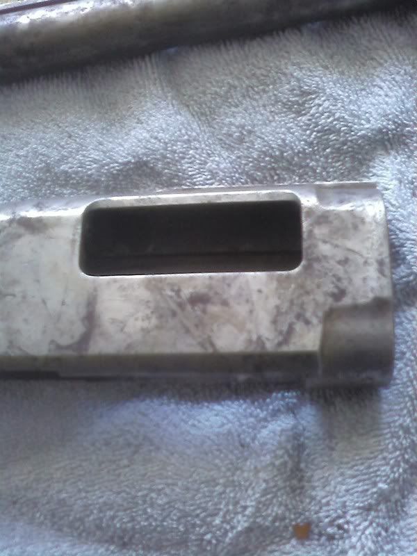

Buddy gave me this:
I took it apart part way:
Now I'm here:
Not sure where to go next. I think I'll polish the whole darn thing as shiny as I can with emery closth and cold blue it.

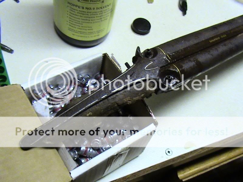

So I go out to a farm to find this old beat up wooden box the owner found buried in his barn ..
http://i69.photobucket.com/albums/i75/slushee1234/SSPX0037.jpg
http://i69.photobucket.com/albums/i75/slushee1234/SSPX0038.jpg
Now this shotgun is probably unregistered, but as I am 'in process' of trying to identify it, and then call to verify it, I believe I am okay with the Amnesty.

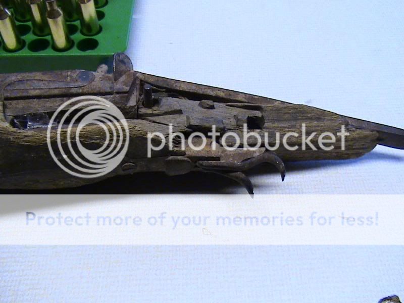

I think this trigger group is seized due to rust..
http://i69.photobucket.com/albums/i75/slushee1234/SSPX0042.jpg

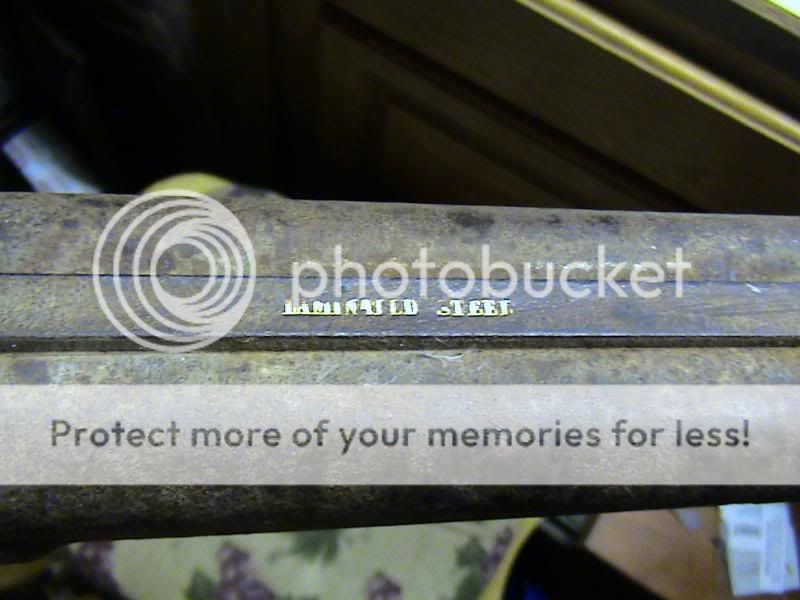

I am having difficulty getting the data stamp information from this barrel .. you can see the rust and pitting..
http://i69.photobucket.com/albums/i75/slushee1234/SSPX0044.jpg
I have been able to figure out its a Winchester Repeating Arms shotgun .. but the rest is very unreadable.
