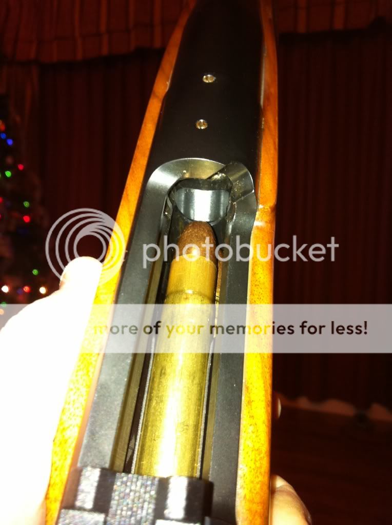

My buddy's .500 s&w handi wasnt bad to shoot, I enjoyed it. So long as you mount it properly... CST Grad C.Nixon, did you use a .300 win mag based rifle for the .458? Did it require any tweaking of the feed lips?
I couldn't figure out how to get 2 actions to work at the same time. If I had 4 times the cash I would have done a double.
If you want my advice you'll save your money and stick with a bolt gun. Much to my chagrin with ten days of exposure I didn't have much luck with the double. The ammo was loaded on the hot side, 580 gr Xs and 580 gr Woodleigh solids over 89 grs of 3031 for about 2150, so the action tended to stick a bit, and there was a knack to breaking it over your knee to get it to open. It had extractors but not ejectors, which is something I don't get either, but to the double enthusiast it seems to matter. By the time I reloaded the .500 I could fire 10 rounds of .375 from a bolt gun. When the PH offered to sell me that rifle for $40K, I told him I wouldn't swap him straight across for my Brno 602, unless he wanted to throw in some cash with it . . . I think I hurt his feelings.:eek:
It is a long action with a magnum boltface, (I do not know if it was directly a .300WM action, I placed my order for the specs as to what I wanted, and they provided the action/bolt) the feedlips can suffice (for now anyway, I hope to open them up at a shallower gradient in the future since these blunt nosed bullets and a steep angle dont want to get along together very much), and I'll have to beef up the mag spring cause the darn belts on these cartridges dont make life any easier :D
