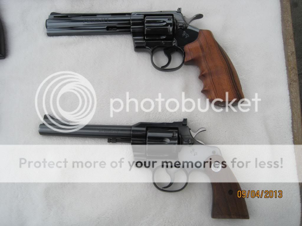

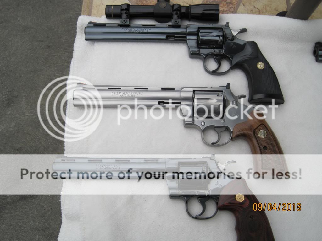

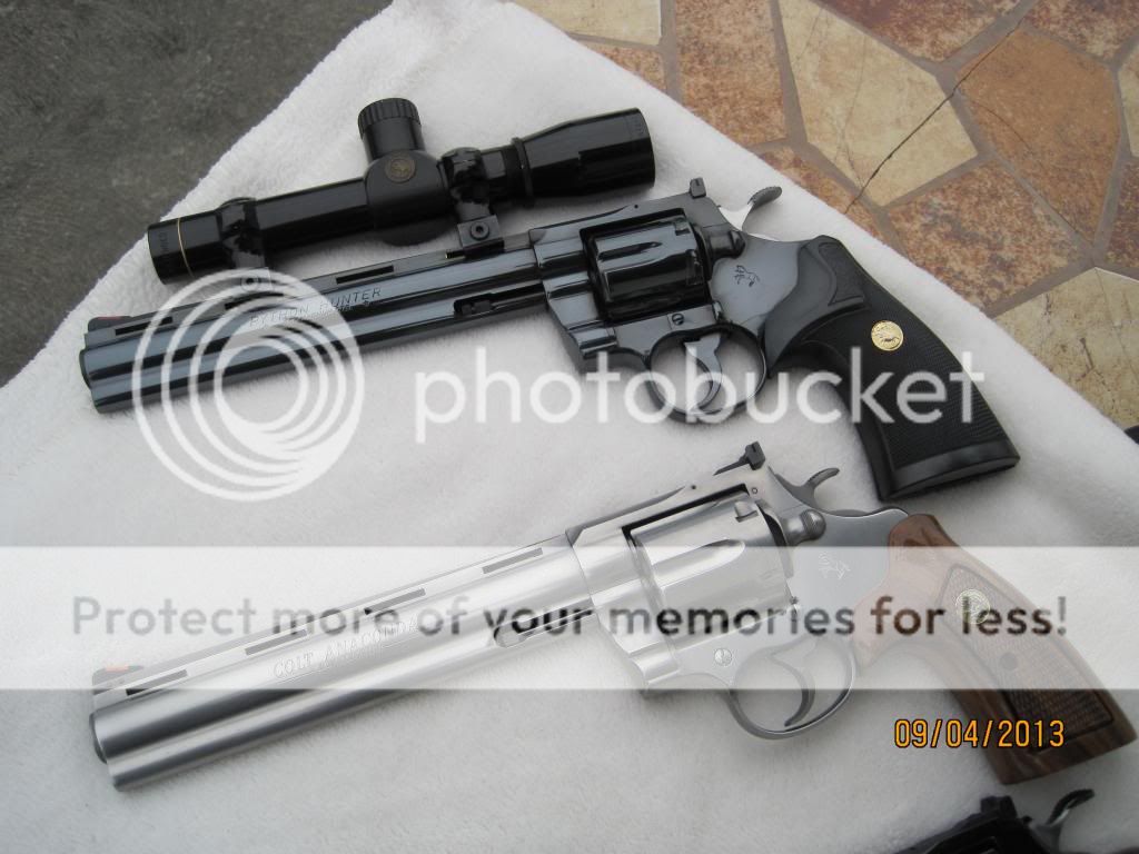

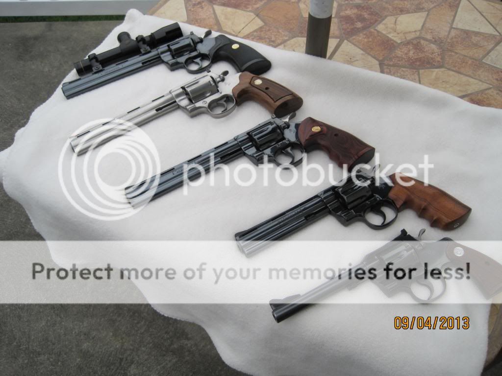

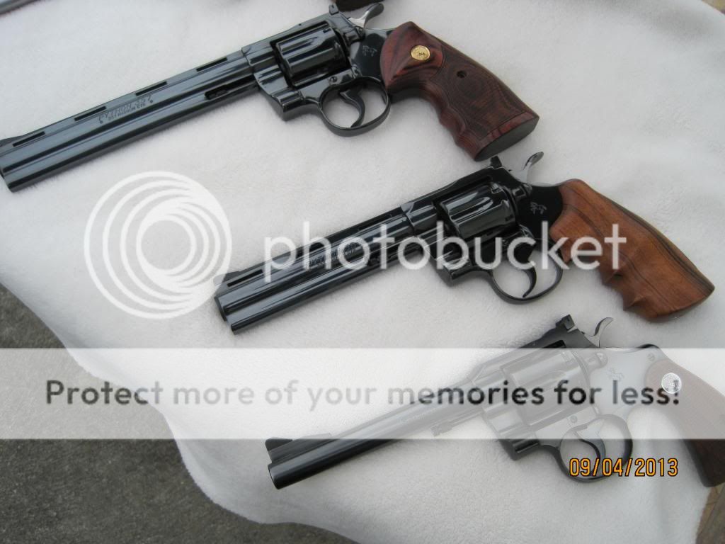

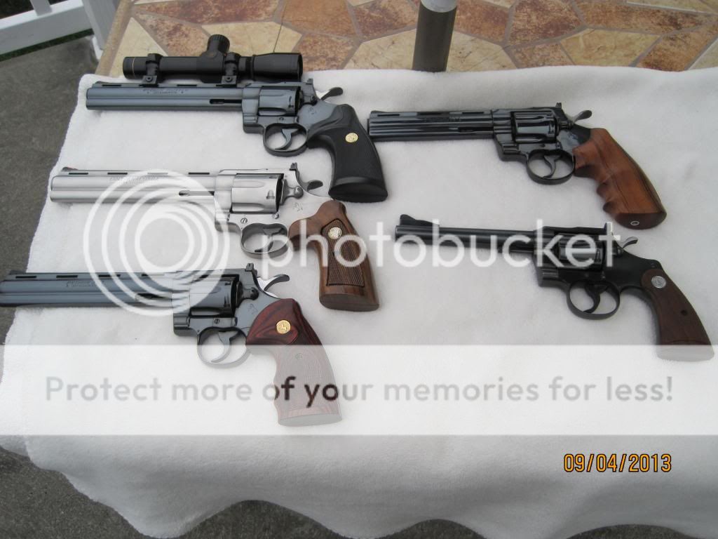

Someone ask me to put my Colt Snake's Family in the post so here it is !
Sorry for the quality i was in the hurry because of the raining.
From the first pic one to five:
1) Python Hunter
2) Anaconda hunter ( have just left the scope in the case kit for storage )
3) Python 8 inch royal blue
4) Python 6 inch Royal blue
5) Not a snake but a old model 357 in incredible shape somes call them Pre Python

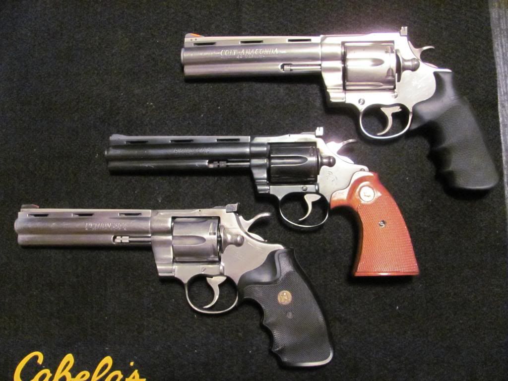

My family of snakes. Anaconda, Diamondback 22lr, and Python.
Nice what year are they?
