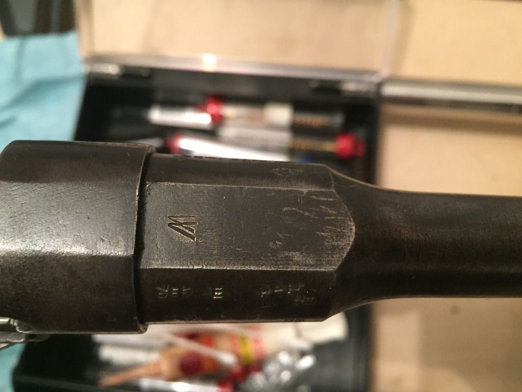

Well after a night of scouring i still have come up empty. I'm struggling with the markings of my newly acquired no1 mk3. I'm interested in what these marks mean and what's it story. I would greatly appreciate any help or a direction to go.

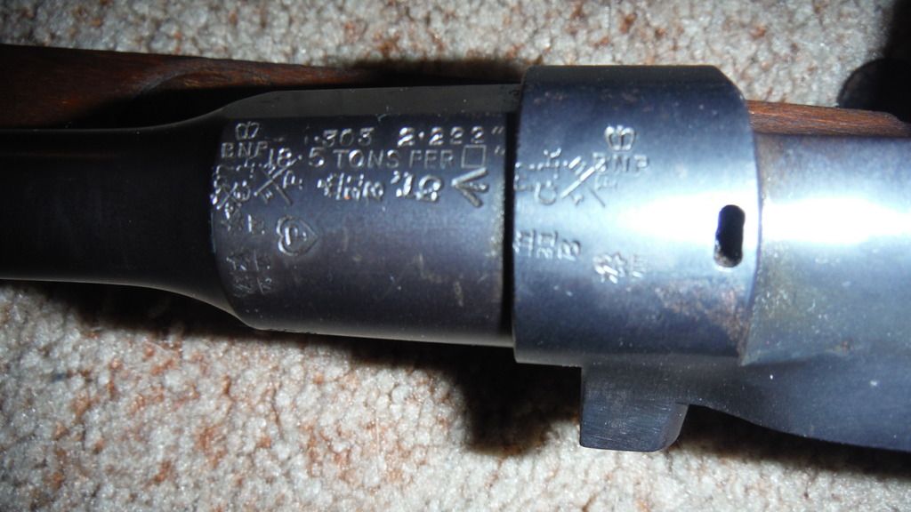

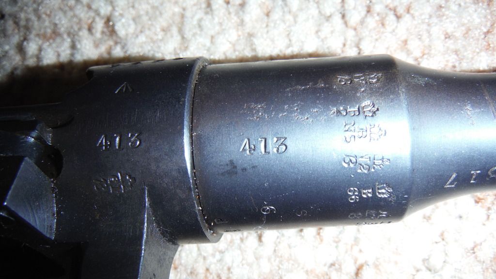

Looks like a matching receiver, barrel, bolt and rear sight. Rifle was proofed in 42 but I think it is still the original barrel. I take it is a barreled action since there are no pictures of the fore stock or nose cap.
Pretty sure that is a replacement 1942 barrel. Font is different font and it doesn't have a earlier proofing. There rear sight is also a replacement rear sight. Still makes it all matching, just not factory original to the rifle.
Here is my 1912 No. 1 Mk. 3 with matching barrel for comparison. Note the 1912 proofed barrel, and the assembly numbers which are the same font and size.
This is great. Thanks for the help. Barrel is still in great shape a 1942 replacment. The nose cap matches the rest but only has the serial number. No numbers on stock there is a small mark that looks like ftr on butt stock behind trigger. Are any of these markings indicating a Canadian linage? Also what does the V represent on the barrel or is it a double vv? Also on the 6th image There is a broad arrow with two circles
Which is different than the rest?? Finally what else would tell me a year of the rifle seeing that most of the marks on the reciver part are worn off? It was advertise 1916 for curiosity sakes I'd like to know what marks would mean this.

It is a 1910-16 Enfield made Sht.LE Mk.III. 1910 is earliest because it has a George Rex proof mark (King George V 1910-1937) on the left receiver ring. It is a Mk.III which went to III* in 1915/16. There is a marking under the III that has some relevance but I cant read it. '18 ?? '12 ??
Looking at the left butt socket '37 denotes that is went back to the factory for significant work in 1937. There should be a tiny inspector stamp close by to the '37 which will tell as to which factory.
It has had a barrel changed and fitted in 1942. Enfield made barrel. It was renumbered to match the receiver. There are a number of RSAF inspector markings on the right hand barrel reinforce which often indicates that there was some work done on the barrel, chamber or sights.
The rear sight bed is a post 1925 Enfield unit that was pulled out of a parts bin and fitted. While the base had been sitting in stores, it was picked at random as part of a 10% of inventory inspection and thus marked o/l\o. The sight leaf is a replacement too, a good used part out of the parts bin, old number cancelled then and renumbered to match the rifle.
BSA on the underside of the barrel is likely an ownership marking for the British South Africa Co.. An outfit organised much in the same way as that of the East India Company. Is there a three digit number adjacent to it?
Single hand stamps, so we cant rule out that it could be simply a previous owner's initials (Bertram Samuel Atkins?).
This rifle was probably purchased and reassigned duties post WWII. There are no commercial proofs apparent, so this has been sold out of service through channels outside of the British gun trade.

Here are a few more pics. I can't make out what is under the III. Looks like 42

So it appears that it has been back into Depot once in 1935?? and in 1937. I see two dates and two inspector stamps. Very faded, maybe just my imagination but I think that I can see a face down E in the lower inspector stamp. Wishful thinking staring at a ghost of a stamping, but it would fit, refurb at RSAF Enfield.
The '42 on the right side is again a marking to show that it went back to the factory for repair or upgrade. Makes sense as the replacement barrel was fitted up in 1942 (could be the same '42 hand stamp used on both barrel and receiver ring). It usually appears on the left but sometimes on the right side contrary to the 'Instructions for Armourers'. Often this date can be seen with the marking FR or FTR for Factory Thorough Rebuild. But not in this case.

The marking on the fore arm is a super imposed E, F and a D. This is a RSAF Enfield marking which first appeared in 1925. The numbers would be the serial number. Nice, it matches so there is a good chance that the factory bedding is still good.
The markings on the underside of the butt wrist look to be a common inspector mark and two initials, probably to denote the subcontractor who made the butt stock. Too faded to read.

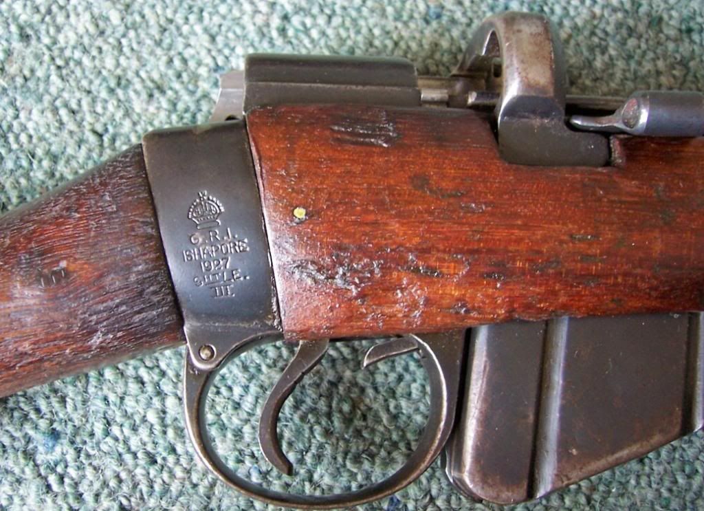

A 1927 Ishapore MkIII

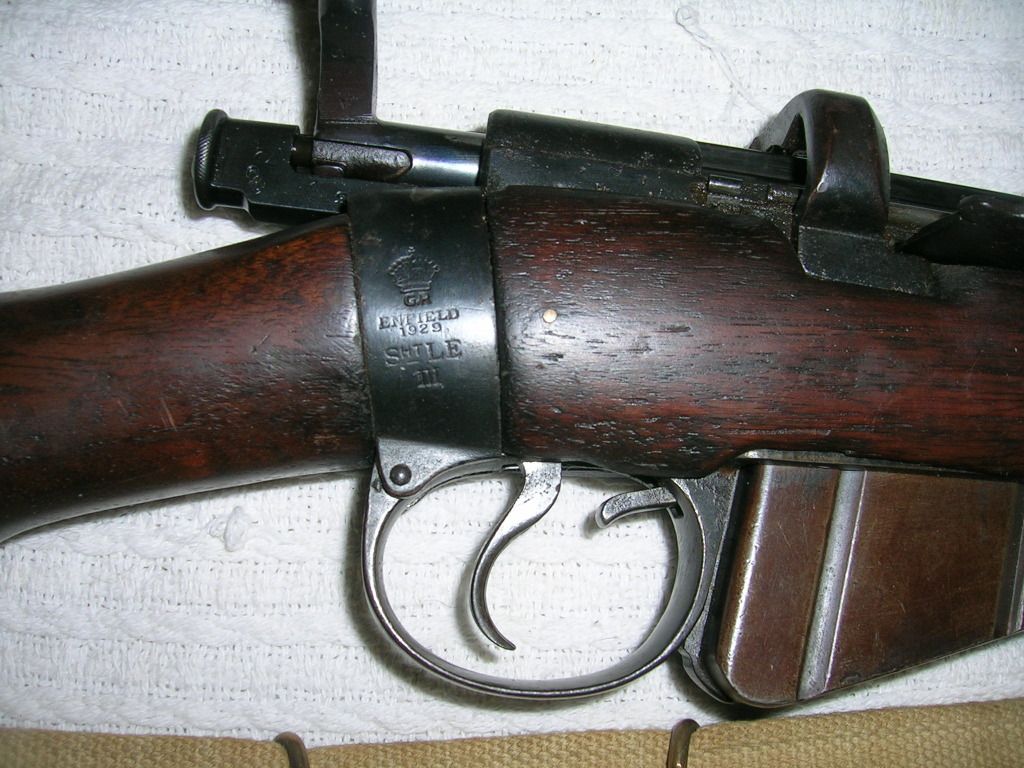

A 1929 ENFIELD MkIII

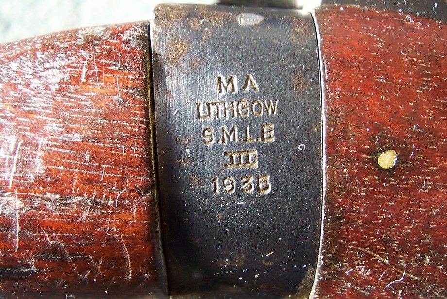

A 1935 Lithgow MkIII

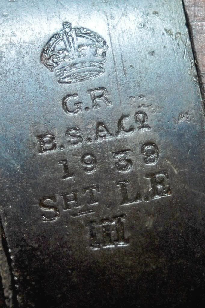

A 1939 BSA MkIII
