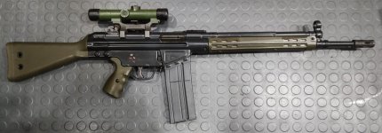

Just wanted to thank you for inadvertantly confirming my long-held suspicions regarding the origins and purpose of a G3A3 that I've had for many years. My G3 bears the identical Coat of Arms and "AL" stamp shown in your photos. It was French manufacture for what you have now confirmed through your photos was the Lebanese Army. This makes eminent sense once you realize that a Post-WW2 French Mandate (Lebanon was essentialy a French colony) granted "Greater Laebanon" its independence in 1946. It is therefore no surprise that France provided weapons to the Lebanese Army over the years.

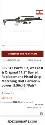

Below is part of the description that is posted with the SIG kits.
