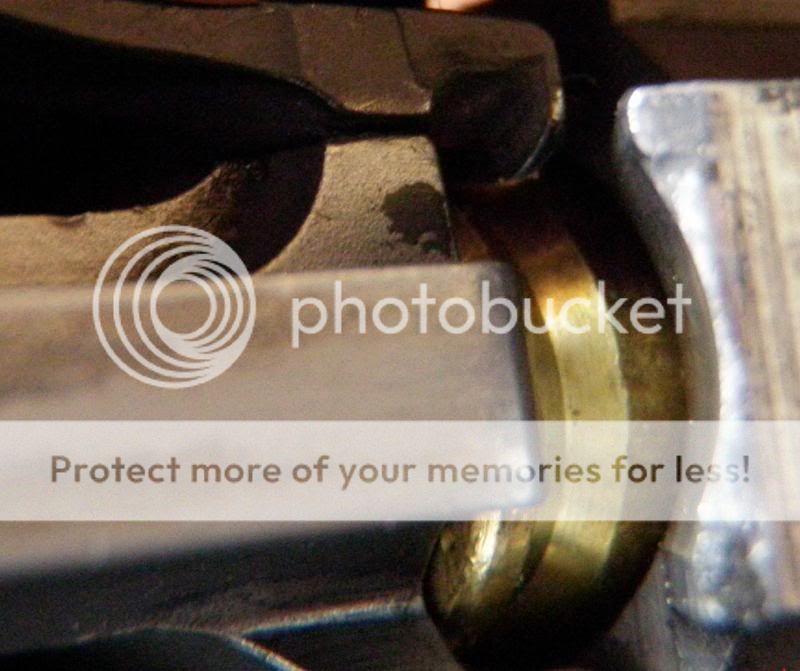

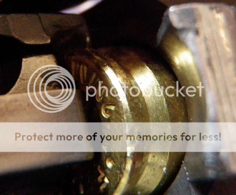

I then realized that when the barrel is locked the extractor sits at its lowest "resting" position because it is positioned below the center point of the case head. When the barrel drops to the unlocked position case lowers itself onto the extractor, acting as a cam that lifts the extractor slightly because of the case's round shape (see pictures below and notice how the extractor is slightly lifted in the bottom picture). But as it sits in the unlocked position, even though the extractor is being lifted by the case, it is still deeply seated into the rim grove. So what would cause it to lift away from the grove? The answer: Momentum. During firing the barrel drops to the unlocked position in a fraction of a second. At this speed the case rim cams the extractor outwards so fast that the extractor continues to lift under its own momentum after the barrel has finished dropping. When the extraction begins the extractor claw barely has any material to hold onto and simply slips off leaving a burr on the outer edge of the case rim.
Locked position:
sorry for the cleanliness (or lack thereof) of the gun.
Unlocked position:
(Notice how the extractor is slightly lifted in the unlocked position)

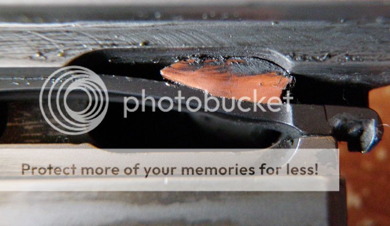

Regardless of what the true cause is there is a very simple fix: Increase the spring tension of the extractor. This way it will not move outwards as far under its own momentum and will spring back inwards earlier. I achieved this by cutting down a piece of stiff and sturdy rubber (The kind that will not rip easily. In my case I used an old Accuwedge) so it fitted snugly behind the extractor (see picture below). It is not visible in the picture but I have cut the piece of rubber so it steps to a thicker size underneath the extractor so once it is pushed in it locks in place. It hasn't moved from there since I've installed it.
