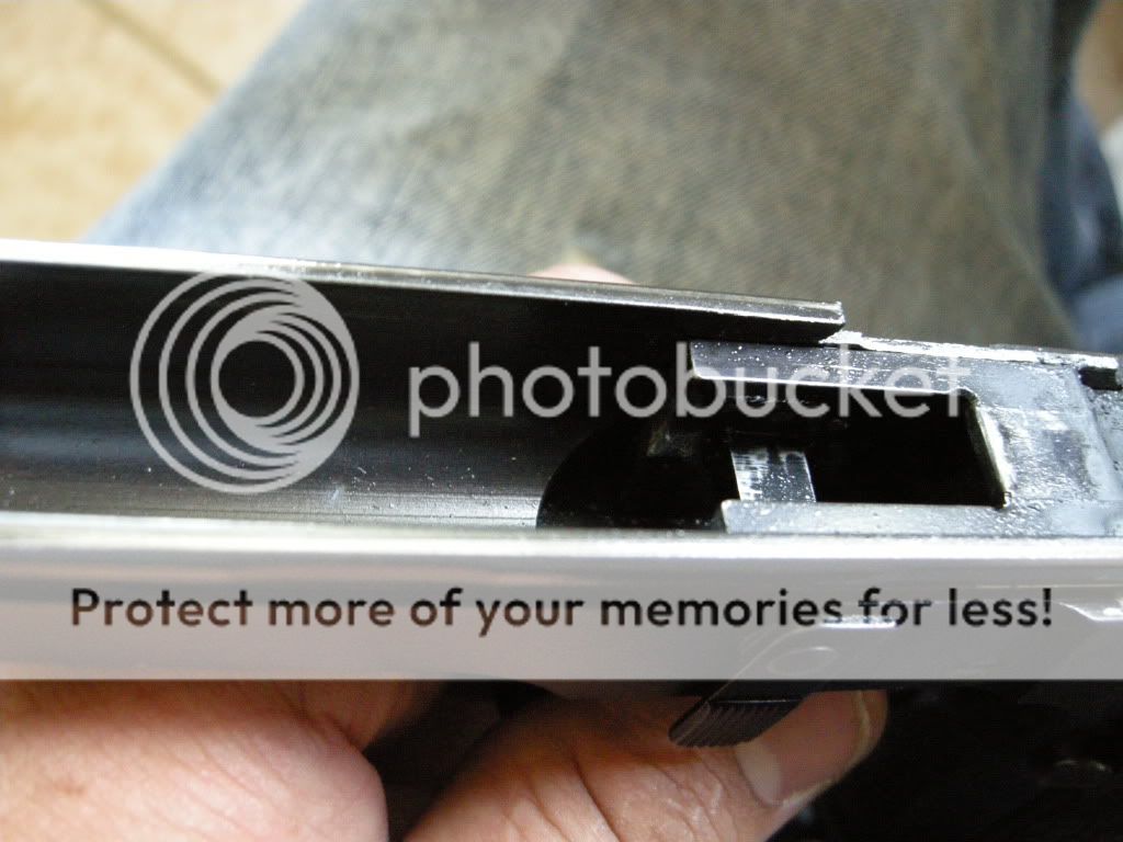

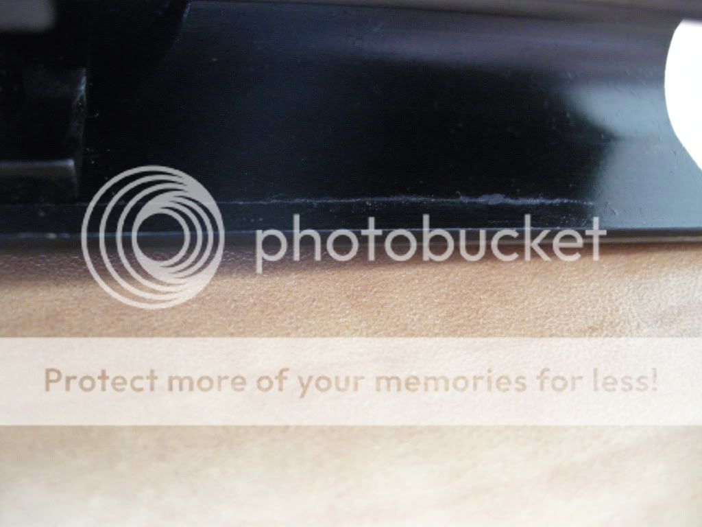

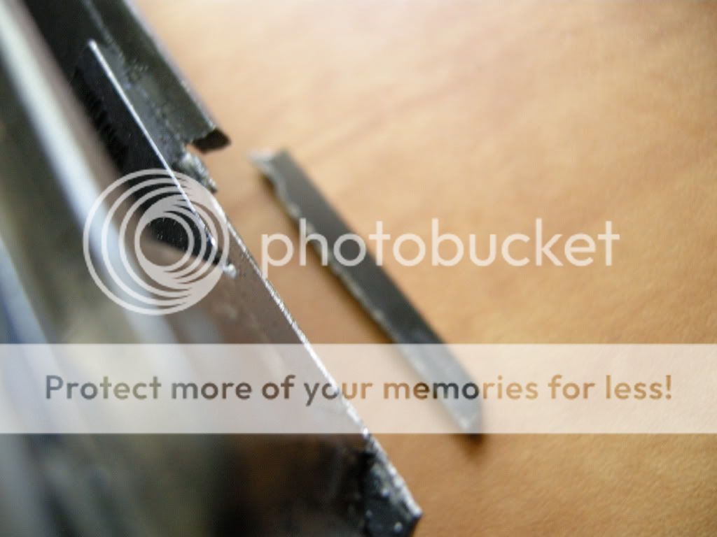

So the story starts a couple of days ago when i decided i was going to start reloading, well a half way through reloading 200 9mm shells i noticed a screw was loose on my new powder measure. well i was suppose to be loading 5.0 gr of powder into my shells ( which i was to start with) i decided checking ever tenth shell was an unnecessary practice, then i noticed some casings had more powder than looked proper , remeasured found i was putting 6.8 gr of powder in and a screw was loose on my measure. threw out the last 20 round i pressed and re calibrated. today went to the range to try them out got through about 150, when a piece of my rail got caught in the chamber( oh ####) i am wondering if it is advisable or possible to weld the crack back together or if a gun smith might be able to fix it. i have attached picture to show the damage. will be checking my powder measure every ten shells from now on. any help welcome.

That's more than cracked. That's broken. Like Grizzlypeg says, there's no fixing it. Not likely to be caused by over loaded ammo either. Barrels will break before the frame.

There is no fixing that.
Just thinking out loud... Didn't the new NP series have rails built into the locking block to prevent this from happening?
If one were to cut away the remaining rail on the other side and fit such a locking block it might be fixable... The rail might have a gap in it but it still might work... how one would get such a locking block...?
*EDIT* I just realized from the one pic that the remaining rail is cracked forward as well, isn't it? I guess that blows my idea out of the water...

What does the empty brass look like from the rounds that you fired. How do the primers look?
Never seen a broken slide rail like that on a SIG before.
Maybe post this thread and pics on sigforum to see if any of those guru`s have any worthwhile input.
look at the serial number, that gun is pretty old ( +15 years ). Sig will not even go there if you called them. Up to over the 300k mark Sigs had problems with the rails cracking, If they were not maintained. I have a Sig in the same serial number range with over 70k through it. I have to keep it super lubed so there's less stress on the rails and I shoot lite puff, puff practice rounds through her only.
