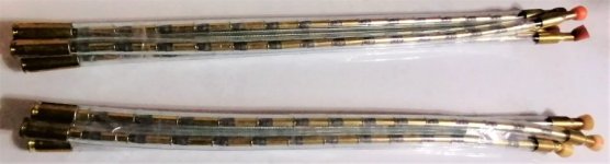

Amazon has 'Speed-Loading tubes' for about $35, holds 8x tubes of 'however many rounds you choose'. I made my own years ago - vinyl 'fridge water tube & cut 308 cases w- ear-plug 'caps'. Fill em the nite b4 . . . only take a couple minutes per loader if you shoot more than 120 (in my Marlin 60).
