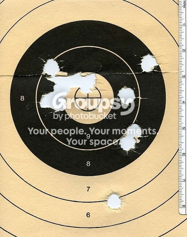

Although I haven't done much with my muzzleloaders for the past 15 or 20 years (having gone more into black powder cartridge shooting) in my experience, a tightly patched ball in a good smoothbore barrel will be quite accurate out to 75 yards or so. As an example, this is a 10 shot 50 yard group (from a rest) with my Miroku reproduction Brown Bess musket (flintlock, .75 caliber, if you aren't familiar with them .... admittedly shot nearly a quarter century ago!)
