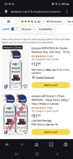

Could try a can of that keyboard cleaner air stuff to bring in the field if it's that bad. If its just dry dust that'll blow most of it off.
I use those cans all the time when cleaning actions to blow the crap out of little crevices.

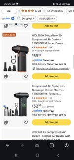

Edit: I checked amazon to get a picture of those cans and apparently there's little battery powered things now. Not a direct replacement but might be an option.
