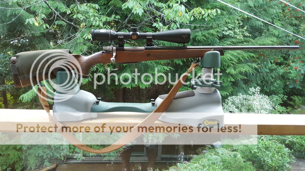

I have the same rifle as my hunting rig and I quite like carrying it in the bush. Accuracy is good with my hand loads, weight is good, the bolt always works effortlessly though it is an odd shaped bolt handle and therefore requires high rings. My PH is as old as me and I hope to have it for years to come.
Anyone know if most PH have the odd sized bolt handle? Im a small guy, and high rings are not a good combo for me...
