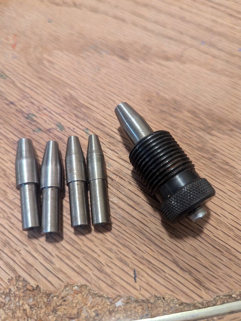

I use one of these and just whip up any size I need as I go on the lathe. I've also been lazy and turned some town while trying to be quick
