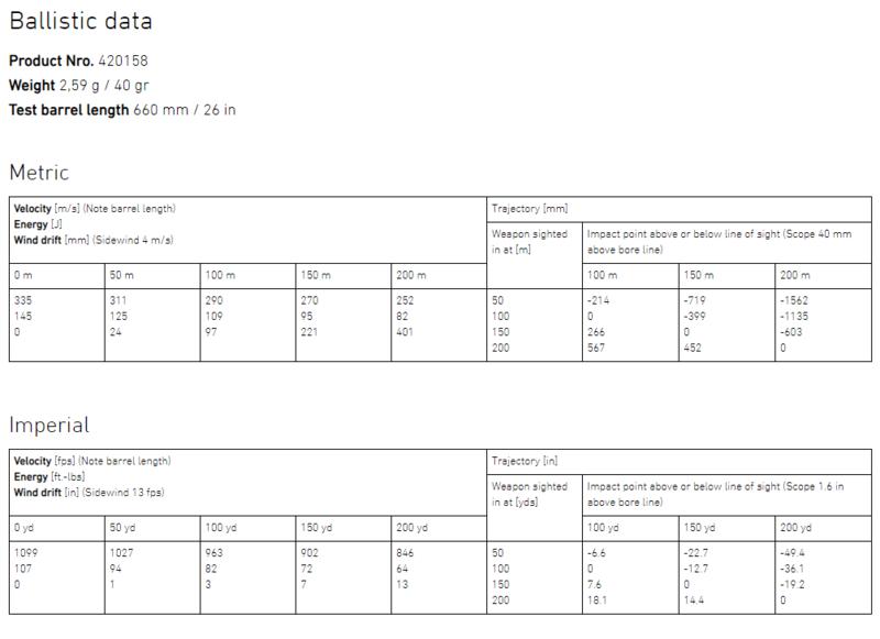

So only slightly faster than typical match ammo, same bullet weight. Going to assume same BC.

SPECIFICATION Version: 14.12.18
Nammo Schönebeck GmbH
.22 Long Rifle Long Range Match
DESCRIPTION WEIGHT
CARTRIDGE Product code:
420113
3,40 g / 52.47 gr
(approx.)
BULLET Lead with antimony 2,59 g / 40 gr
CARTRIDGE CASE Brass (CuZn30) 0,70 g / 10.8 gr
POWDER Single base powder 0,07 g / 1.08 gr
PRIMER Anti-corrosive priming
composition, non-mercuric,
non erosive
0,038 g / 0.59 gr
PACKING
50 rds with a plastic grid in a paper box, 10x50 cartridges in a 500 shot carton, 10x500 shot
cartons in a corr. carton (gross weight: 18,5 kg)
SK ammunition is packed according to the latest regulations for sea transport (IMDG-CODE) and
in according to the IATA regulations for dangerous goods for air carriage.
SK cartridges are manufactured according to CIP regulations and are approved by the Nammo
Schönebeck GmbH quality control center under strict regulations.
