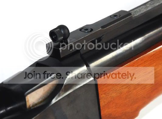

Skinner is now making a peep sight for the Ruger No.1
The windage adjustment is interesting.
It would look better if the muzzle end wasn't so blunt, maybe scalloped with a ball nose cutter like the sides at the front, but deeper.
$75 for the blued version, they also make it in brass and stainless for a little more.
It comes with a .096" aperature.
I ordered the blued version with an extra .155" aperature. :)
The rear screw hole is slotted and the whole thing pivots side to side on the front screw.
If you need a lot of windage to get it lined up it, it will probably ride off the rib a little.
Not perfect, but less bulky than the NECG, and a lot more open for a hunting sight.

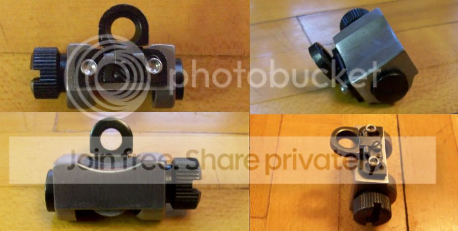

Here is one that IS quick detach.
I cobbled it together from a Ruger ring and a folding peep sight from a Redfield base.
Haven't tried it out yet.
Hope it's close because there isn't a lot of windage adjustment.
Elavation shouldn't be a problem.
