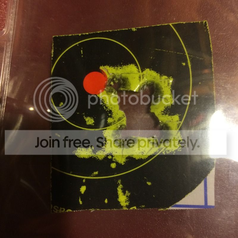

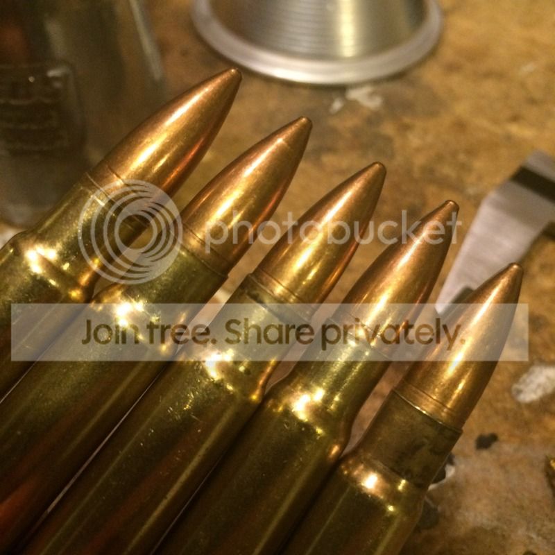

Well, that was exciting! I just tried some pulled sks 125 gr bullets over 41 gr of 4895 in my #4 at 50 yards....about a 0.5" group and a blast to shoot. COL of 2.91 and they even worked in my mag and are within 2" point of pact of my 174gr reloads at that range. Happy dance! This was the first time trying something like this. Fun! Now I need to negotiate a "bullet pulling rate" with my teenager ;-)
