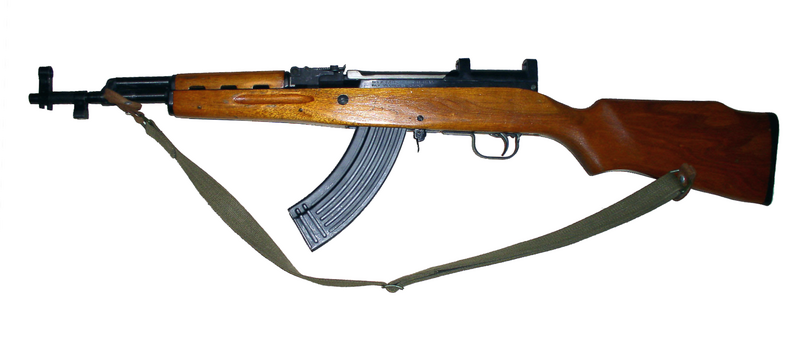

Well guys the previous owner who didnt take good care of the sweet baby decided to get rid of the bayonet.
The base plate dose not look like any other of my SKS's I need some help to replace it thanks.
I don't mean to be an ass here, but I don't recall seeing any D's with bayonets attached (my memory could be faulty mind you) .... Are you sure they came with one originally ?
What you are looking at could be simply an unfinished bayonet lug from a standard SKS barrel that was fitted to a D model.

That style of D needs a new front sight base in order to utilize a bayonet. Kind of a pain in the ass to press off the old one and get the new one pressed and pinned so its not crooked. Then use a router to make the cutout for the bayonet in the wood. I think its more trouble than its worth... I had a D model like that, it was dated 2004 and had that same unfinished bayonet lug. Had I known that the price of the D would jump so much I would have ordered a crate of them as they were selling for 199 bucks back then (early 2004)! Damn 20/20 hindsight... :)
Your SKS D is of the later/last batches and was not equipped with a bayonet. The circular screw on the bottom of the lug contains a plunger and spring to keep tension on the cleaning rod, preventing it from just falling out, a function ordinarily performed by the bayonet handle when so equipped.

okay hmm so is there any way to actually get a bayonet put on or do i have to live with that hump ?
live with it cos its not worth the headache of replacing the front sight/bayo lug besides it gonna be a bugger to find the part , i tried .

I own two styles of SKS-D's. One is an original production with no bayo cut in the stock and the accompanying non-existent bayonet lug. Instead it has a bearing inside the lug that holds the cleaning rod in place. My other SKS-D has a spike bayo and holds the cleaning rod the same way a standard Norinco SKS does. It was imported by Calarms I believe out of the U.S. (the manual is in the safe and I am too lazy to look) Your rifle was designed from the factory "not" to hold a bayonet.
Replace the whole front sight block with a standard type and cut a clearance slot in the stock for the bayonet when folded. Your "D" may also have a shorter barrel than standard so you may not have enough fore end for a stowed bayonet.
