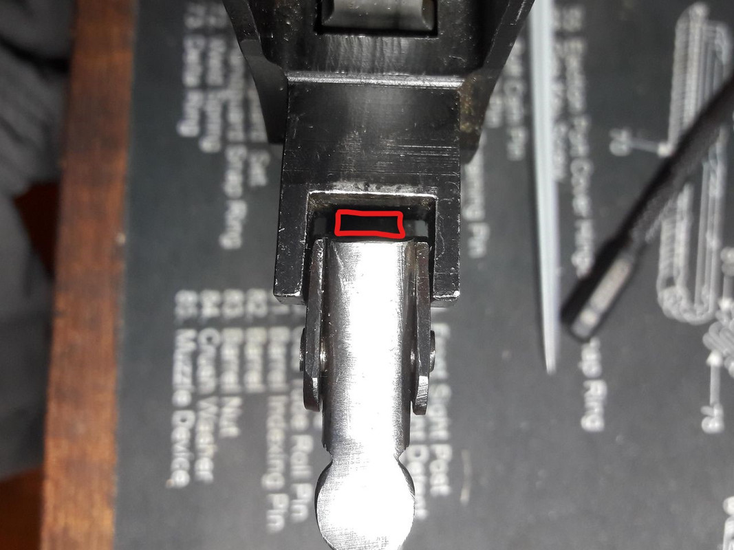

I was wondering if anyone is having problems extracting magazines from SKS-D (early import, with AK-style magazine latch)?

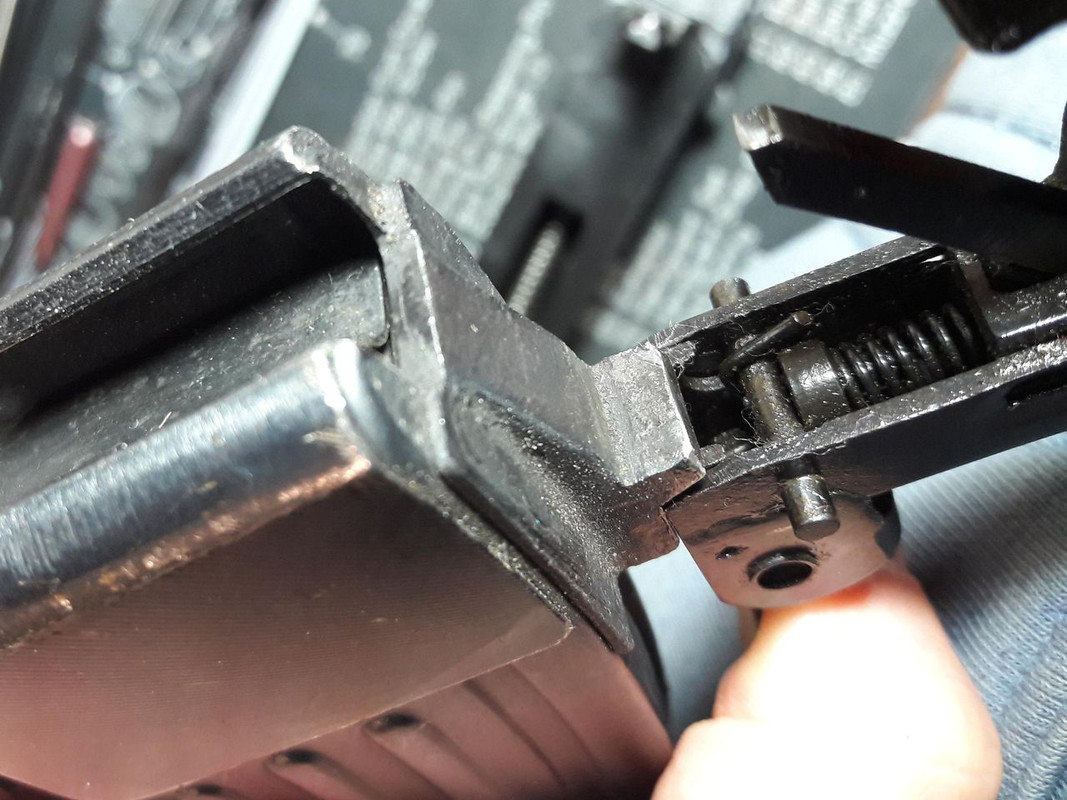

What happens is magazine lug sometimes catches one of side walls of trigger unit and this prevents removal.
Here's how the mag catch looks like.
Here's how magazine lug suppose to be positioned.
However it can be shifted left or right and this will prevent mag removal, because it's now caught above the trigger unit wall.
Here is how it looks with magazine and mag catch.
Having higher walls of trigger unit would prevent such an issue
Or having thinker walls of receiver in this place would prevent this.
Another possible way to fix is to round the angle of trigger unit walls.
And extending the walls forward would also prevent mag lug from shifting left or right.
So basically two questions: do you experience such an issue with your D and if so - how did you resolve it? I would rather stick to reversible fix/mod when it's possible.

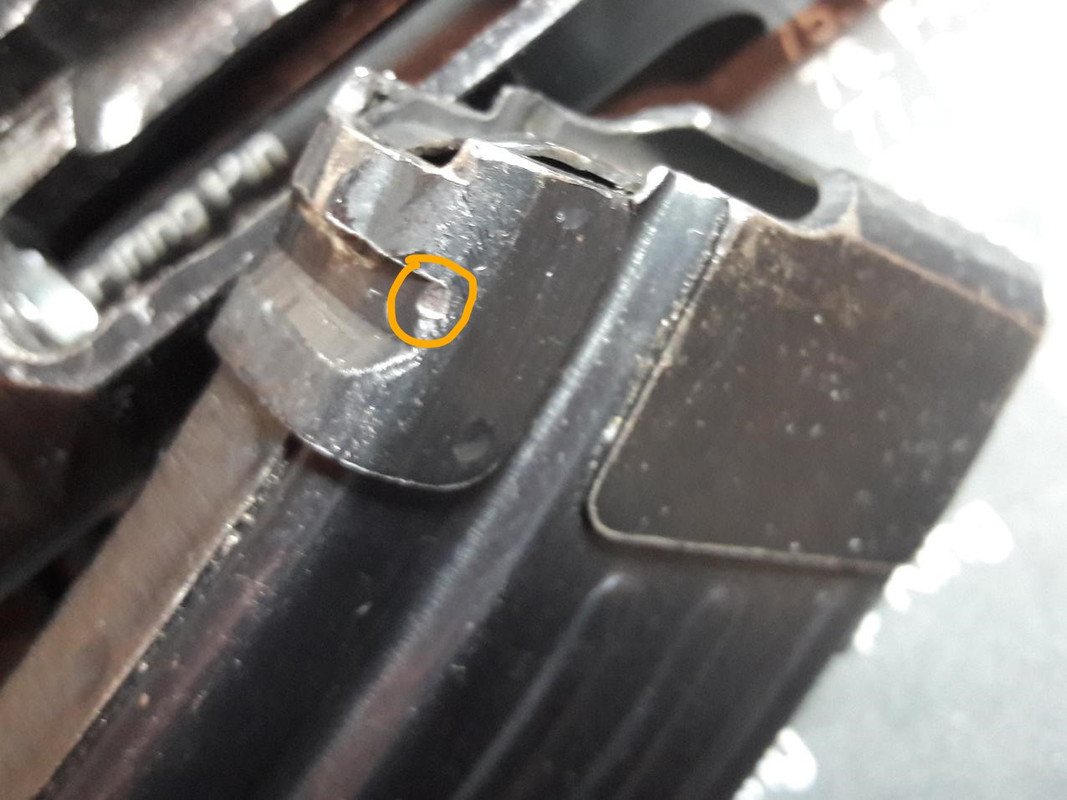

Thanks for bringing this to my attention. I don't think mag needed to sink in more, however I looked closely and found not quite perfect shape of the well. It looks like in the upper left corner rounding was not sufficient. Upon closer examination it turned out that in this part mag was not allowed to sit in its proper position and was pivoting to the opposite side. Examination of the mag confirmed the issue, one can see where mag surface was heavily rubbed by the edge of the receiver well, that was the case with all magazines that were tested with this rifle. A little bit of smoothing out with file and now mags are not pivoting to the side and tend not to catch the walls of the trigger unit. I also smoothed those trigger unit walls, as technically one can wiggle the mag into the position to catch those wall. Overall issue came to almost non-existent.
Thanks to everyone who contributed.
