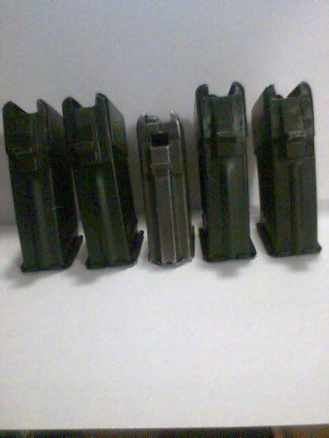

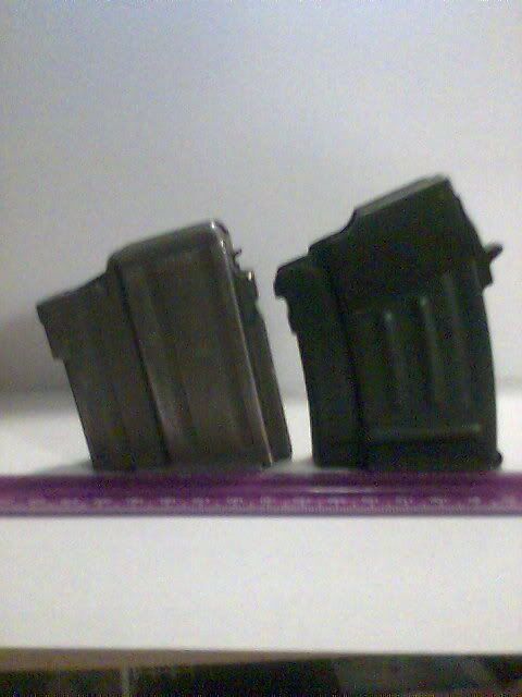

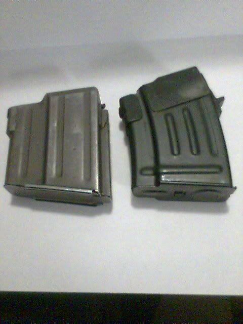

The "10 round AK47/SKS-D" mag he INSISTS he sent me is the middle one. The two mags on the outside are Norinco 5 round mags that fit my SKS-D perfectly.

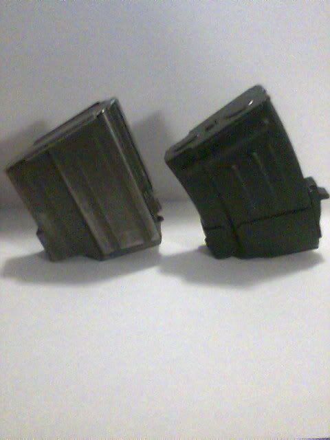

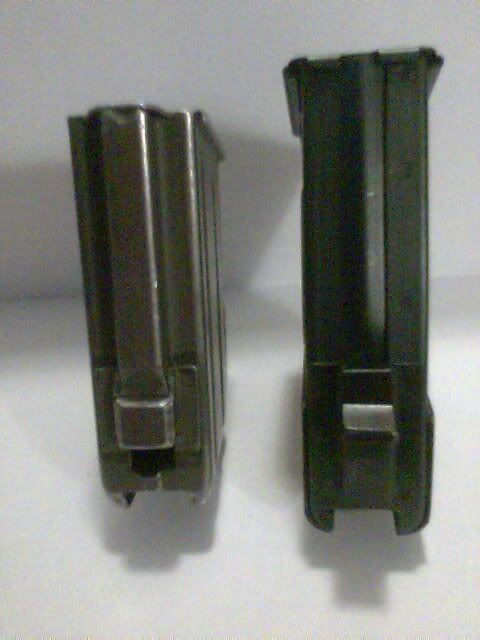

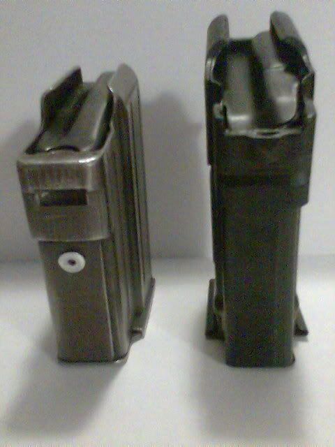

The next pic shows the difference in design with the tabs, both style and location. The REAL SKS-D 5 rnd mag is on the right, his BS "10 rnd" on the left

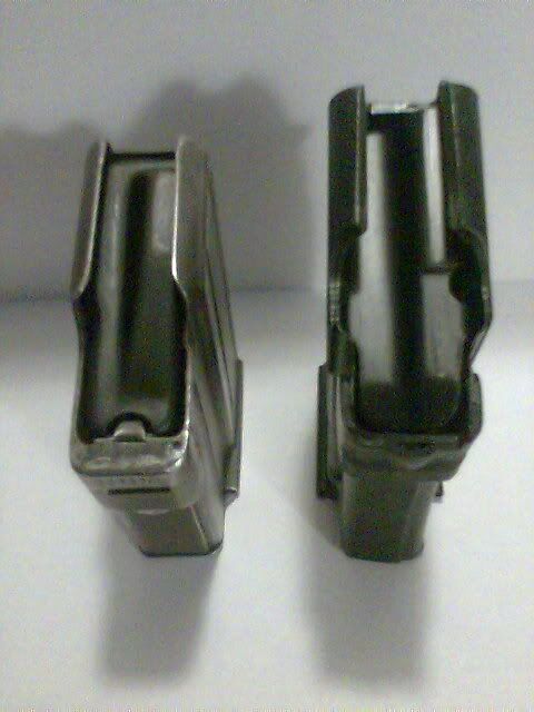

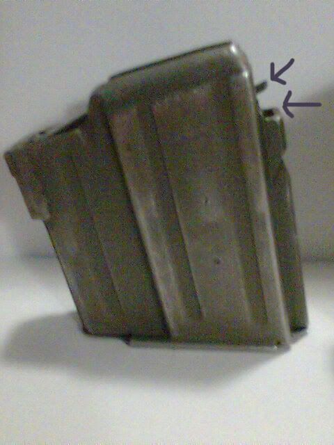

The following pic shows the little tab thing on the BS "10 rounder", the arrows show the range of movement this little tab has.

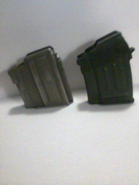

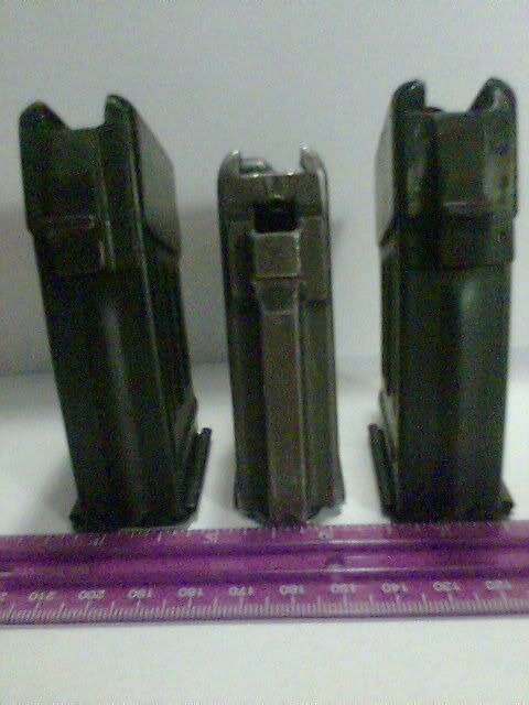

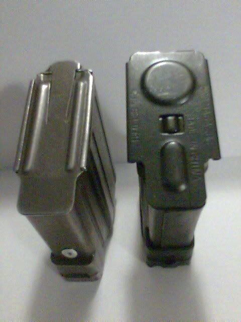

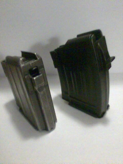

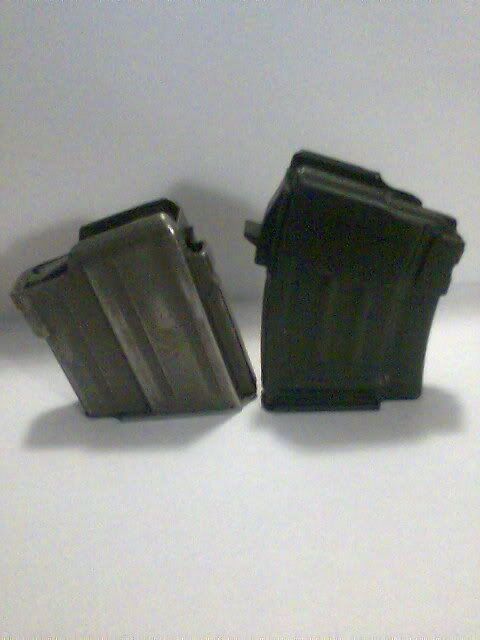

More pics below showing the difference. In all photos, the darker, larger mags are my SKS-D 5 round mags that fit my gun fine. The teeny little lighter coloured "10 rnd AK47/SKS-D" mag is the one he sent me.
All 4 of my 5 rnd sks-d mags that fit my gun, with the BS "10 rnd" mag in the middle.

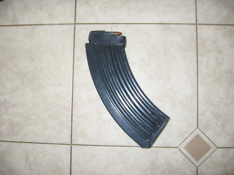

And this a picture of an AK47 10 round magazine from SKS man's site (sksman.com) It sure doesn't look like one the seller sent me!! Damn that Canada Post for shrinking and re-designing things!

Your "bogus" mag is for a Czech Vz 52/57 (7.62x39). It's worth about $75.00 as they are very scarce and in demand here.
