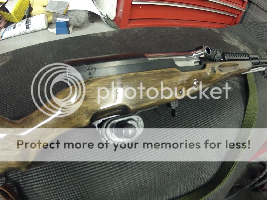

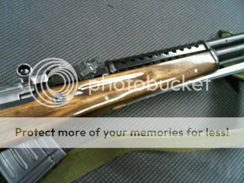

Hey boyz, just got my SKS finished. I am sorry about the pic quality, I will get some better pics. The stock finish is like a mirror and the pics don't do the finish any justice. What are your thoughts? New to the forum and looking forward to showing my toys.......
Thanks! I am happy with the different look. I sanded it down to bare wood. I used black shoe polish rubbed the crap out of it and then polished the stock with a Black and Decker automotive polisher then one light coat of Minwax Wipe on Poly. I used blue paper towels to apply the poly. Then a sand and wipe on black stain over the one coat of poly. Let it dry for about 3 days, light sand to get the grain going and then 25 coats later the grain in the wood is completely filled and looks like a car clear coat. She was a lot of work but worth it. I will get better pics, maybe tomorrow. My dad is a master wood worker and does all kinds of crazy things to get different finishes......
Interesting looking mag. How is the function. I am not a great fan of the after market quality on most of this stuff but that one has a nice subtle change to it.
