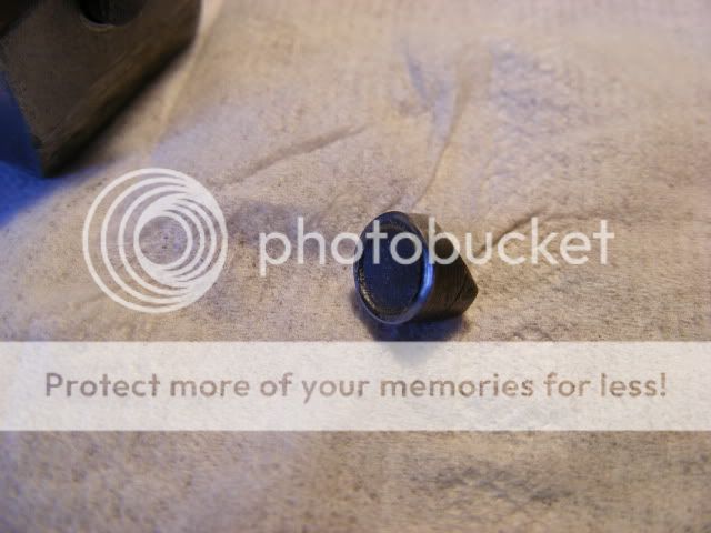

Umm...OK so I pulled my Trade-ex Russian SKS out of the safe (had it for less than 2 months) and cycled it a couple of times because thats an excellent way to end the work week right? Wrong.

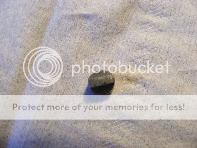

I heard something small land on the ground near my feet - on inspection this is what I found.

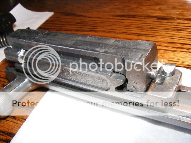

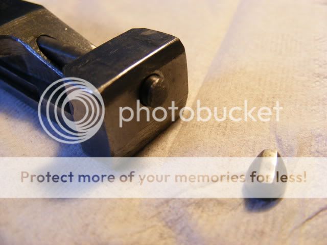

I didn't know what the part was, or if it even came off the SKS but it did look familular - after disassembly I believe what happened is that a peice from the back side of the firing pin just snapped off. You tell me...I only have 1 sks so I cant compare.
I have never heard of anything like this happening from cycling an sks or any semi-auto bolt before. Thoughts?

Confirms that this peice is off the end of my firing pin. (1950)
I guess my concern is 1.) why/ how this happened and of course 2.) the best place to replace the firing pin (preferably for cheap as this is a "cheap" although I thought pretty solid gun).

I too have a 1950 Russian SKS and you indeed have had the back of your spring loaded firing pin snap off. How that happened cycling it I don't know. Well my theory is it was already about to go and happened to fall out then. At least it wasn't at the range just as you set up for a fun day of shooting. IIRC the stickies at the top here are great for identifying all parts. Our 1950's are a little bit of an odd duck being non-chrome lined and having spring loaded firing pins with those being the more obvious differences with multitudes of smaller differences.
http://www.canadiangunnutz.com/forum/showthread.php?t=298930
Look for section J. You should note that our carrier, bolt and firing pin are not interchangeable with later bits. It appears Murray does make a firing pin that can indeed fit a '50 with a different spring.

Your pin is totally different being the original early design. I don't know if anything but an original '49- '50 design pin will work. Youll have to ask if Murrays will work in your setup ( I see they do) oops
murray firing pins will also work in early russian SKS but it needs a shorter spring which murray provides .
