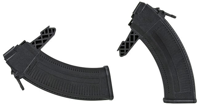

I will never even try their crazy new mag with a small little ##### hanging out:
They failed once, and didn't even apologize to customers ny redesigning this piece of sh$t

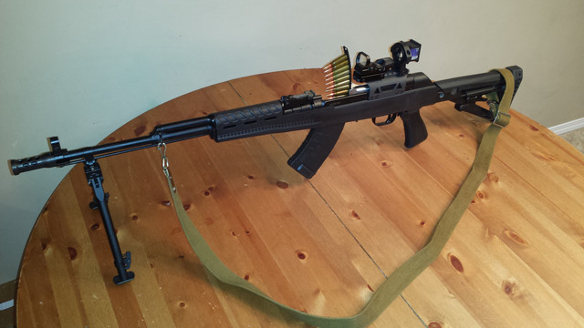

I bought mine off of Dave at HiCal, and he machined the cutout for the AR mag adapter, which I also got from him.
My 1950 Tula clicked in snugly, like it was made for it.
The handguard was a non issue for me, since as an AME I know how to drill out rivets. Also, AA's handguard is directional, so you don't put it in backwards if you don't want trouble.
The AK hump is stupid, and I wanted to mount a Tech Sight TS 200 rear peep sight, so I just carved that stupid hump off.
Now, with the Opfor stock, AR adapter, Tech Sight peep, and the bayonet removed, along with a Magpul Gen 3 sling and a Harris bipod, it's now the most fun battle rifle I've ever had fun with since my FNC1 days.
If I'm just doing 100 yard work at the Langemark range, it's always one of my bring alongs.
In fact, the only thing slowing down my field strip is the peep sight.
When cleaning after corrosive, the handguard goes in the hot water pail along with all the other sooty crap.
All in all, I rate the (carved) Opfor an 8 out of 10.
I bought a Tapco stock for my SKS and then an ArcAngel magazine it seemed to fit after some filing but ended up going with a Tapco magazine because the 35 round mag interfered with my vertical grip/bipod
