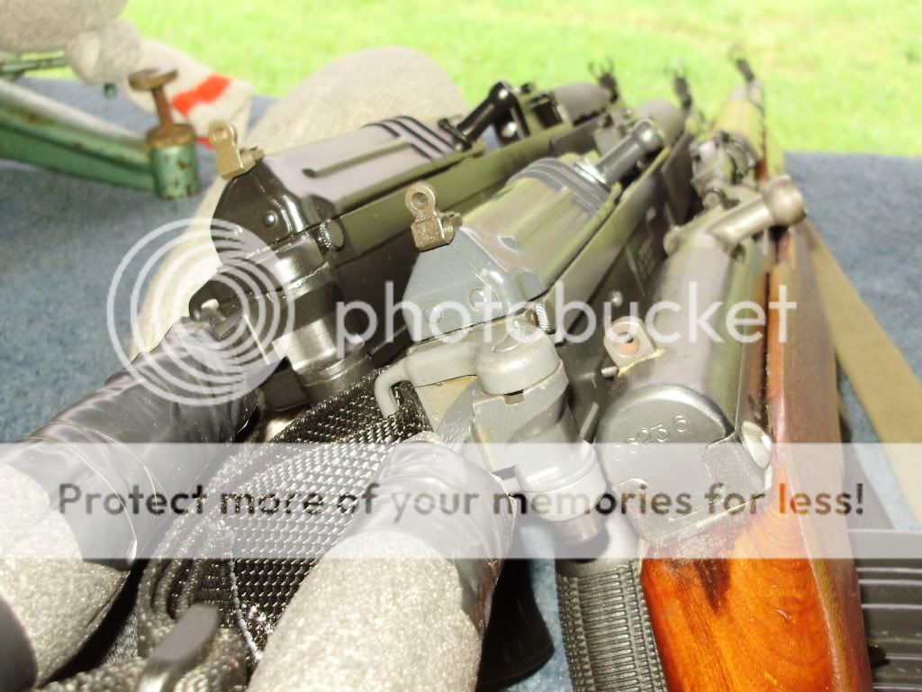

The CZ peep is the complete "L" sight off a AR15. A screw through one of the peeps replaces the rivet usually found at the back of the dust cover. The open sight seen in one of the pictures has since been removed, so as to give me a better sight picture.
With this peep i can get the accuracy the rifle is capable of, even with the short sight radius of the 11.5" barreled carbine.
