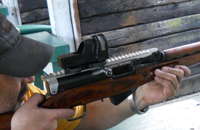

We have an exciting new rail coming, made in Canada by the local company MAG-WEDGE
Stock models will be black anodized,
We should have them in stock next week
looks nice, but what about how the shells eject up is there a deflector plate
Now that looks interesting, CanAm! It would appear to utilize the receiver cover latch pin and the rear sight mount to attach? Maybe worth looking into, I like the added length.
Looks like it can take some hits from the ejected casings and not move.. I modified the ejector port on mine, but the occasional casing still goes up. Probably what killed the scope I just chucked out lol

Damn! That's pretty ###y... Would be awesome with the archangel sks stock when it comes out, to really tacticool it! I'm not looking at my sks right now, but the latch at the back - I'm pretty sure mine isn't circular like that. Does it come with that replacement piece? Any other details how its installed?
Edit: More details on Mag-Wedge's homepage: http://magwedge.com/products/rifle-accessories/sks/
"Nearly a year in development, the Kwik Rail finally allows an SKS shooter the option of adding an optic to a solid platform.
With removal of the rear pin the Kwik Rail pivots up and out of the way for easy cleaning and maintenance.
Equipped with a groove for use as an emergency back-up iron sight. Front sight will require some adjustment.
Made of 6061 Aluminum with black anodize finish. Requires removal of rear sight and receiver cover pin from your SKS. All new hardware is supplied with Kwik Rail.
Made in Canada!
Price: $119.95"
