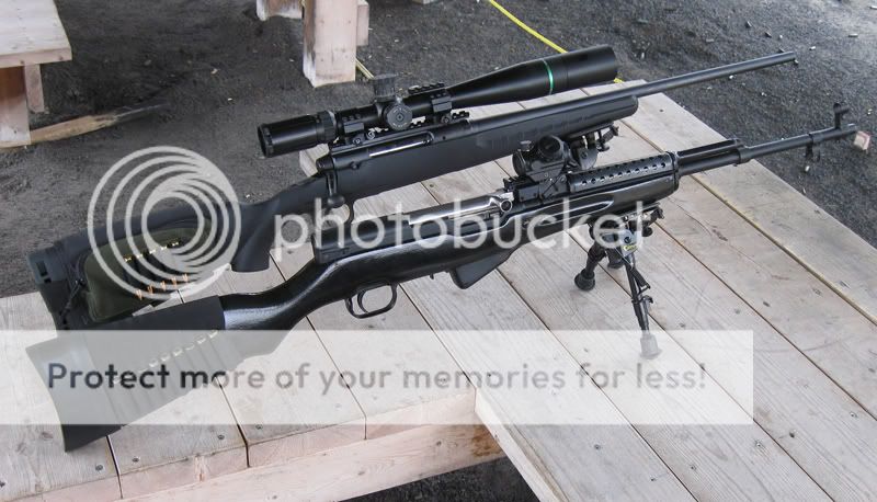

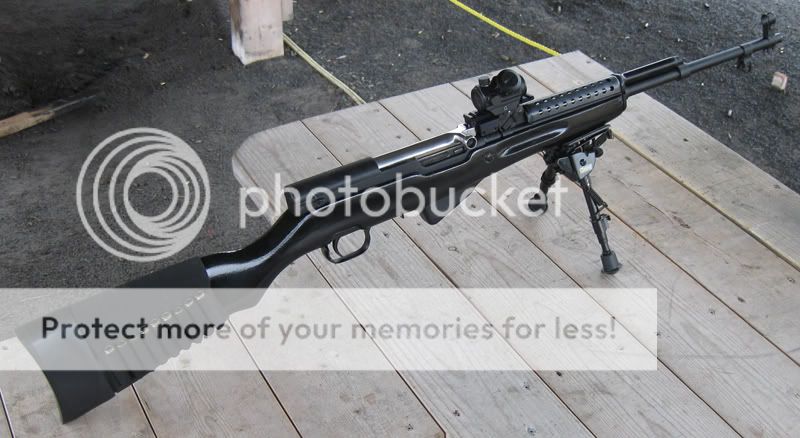

Got the recoil pad to increase the length of pull. Got the buffer to keep my spring in one place. On one of my SkS's I put the B.C. Tactical scout mount and a redot optic and slapped on the Vietnam fiberglass stock witch I bedded and also did the double spring trigger mod to. Constantly will hit a 12x12 inch gong @ 200 meter's. What more do I want from a almost 70 year old design of a rifle. Not much as I save up all my money to trick out my other rig's like, CZ/VZ's, AR's, M14's and so on.
