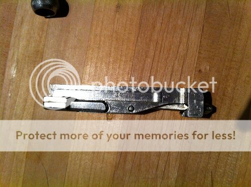

well the front ferrule looks like it been face to face with a grinder or something.
[/URL][/IMG]
[/URL][/IMG]
Has a early cover
[/URL][/IMG]
Yeah that is the later stock ferrule. They did this as it didn't require modifying the later refurb stocks that were used. The 49 type stock for end was slender and matched the smaller front ferrule. So it was easier to put a new ferrule on and then the stock didn't have to be modded to fit the ferrule, and spike was replaced with blade bayo as the stock would have to be modified to accept the spike bayo. Yes the cover was an early one as the release lever it has would only fit the rounded hole. Your SKS shows some of the early original 45SKS details but some changed as well. The hand guard is solid hardwood and the stock laminate. However I don't think it was the original hardwood as it is the lighter color. I suspect yours may have been refurbed more than once. Not unusual on the 49/50 guns...
cool thank you for the information on this matter.
