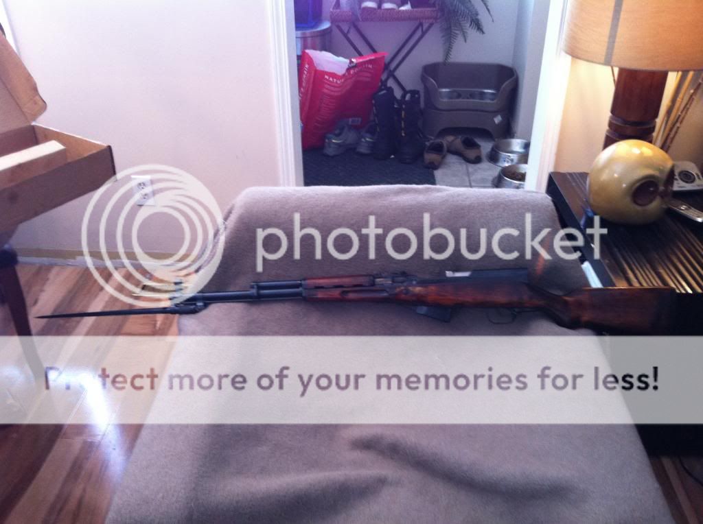

Chinese SKS, as a rule, has a SPIKE bayonet.;) Looking for a new stock to replace a beater. Don't know how many guys offered me a Russky and claimed it was Chinese. :confused:

Correct me if I'm wrong but doesnt the Russian 1949 has a 4 sided spike bayo and the Chinese spike bayo has 3 sides?
49 Russian has a 4 sided edge. Chinese have 3.
Chinese had blade bayonets from 56 to 66. 67 on had spike. China refurbished their SKS, however did not mark them. The refurbished have un-numbered stocks and often have blade bayonets.
