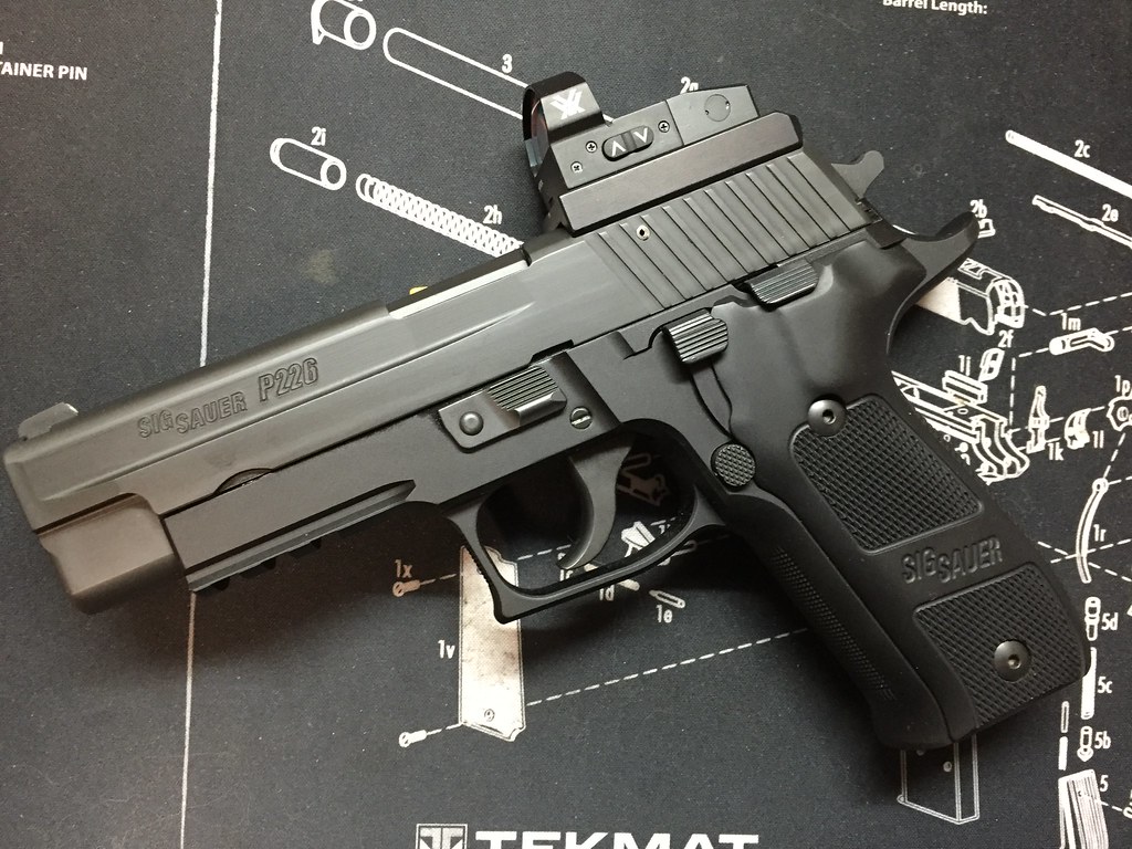

I've got a Venom on a Sig 226. I've only got around 200rnds downrange with it but so far it's still holding zero. Figured with their warranty, if it went wonky, I'll just get it replaced by Vortex. It's just for plinking so doesn't matter if it breaks on me.

Slight sidetrack I know, but how did you mount it?
OST sells (or sold if they still carry 'em) CADEX 226 mounts for them. You'll need to buy metric screws or rethread the base plate. I picked up screws from the local RC shop along with washers. Keep in mind that there are different sizes of the 226 rear dovetail. The 22LR slide differs from the stock P226 which differs from the Elite series.
This is a stock P226 slide on my Elite Dark lower. The drawback is the RDS sits a bit higher over the bore so it takes a few mags to get the feel of looking over the slide. I might have the slide milled down to mount the RDS directly to it.
