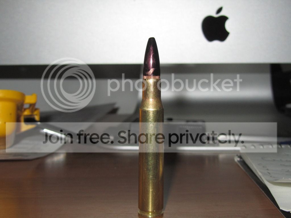

No binding on the cases at all, only the projectile. Got to thinking and decided to cycle a few factory rounds and see if anything there. As you can see in the picture the factory round has the same markings. Being that the factory round measured .3065 and the 110s are .3075, bordering on .308 inches at the ogive, would that thousands, thousand and a half of an inch make much of a difference in felt binding?
If that is the issue, then yes, the metal of the bullet jacket is strong enough to be felt if there is more than a thou press fit.

I don't think the marks on the bullet have anything to do with the interference issue. Have you noticed the difference in the shoulders between the sized case and the factory case? Think, Grasshopper...
It appears the shoulder on the factory round is at a sharper angle or at least more defined. Could this be an issue that the once fired brass is not fire formed to my rifle but some other rifle?
The marks shown on the bullet do not look like the lands are hitting the bullet they look like feed ramp scuff marks coming into the chamber (the marks left by seating too close to the lands are distinct individual scares left around the circumference of the bullet). If you are getting a stiff feeling when closing the bolt I would look to your Full length sizing die and focus on that. The other thing that may want to check out is your trim length. I used to have all kinds of issues with my 30-378 in the Sako chamber and what I ended up doing was trimming my my cases an extra couple thou and that fixed the problems. Every rifle has a unique chamber dimension and a thou here and a thou of an inch there is sometimes the issue. Good Luck.
