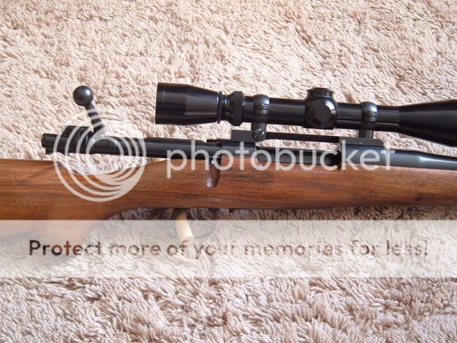

With slow rust bluing, you prepare the metal, degrease, apply the chemical cold with a cotton ball, let rust for a period of time, boil for 10-15 min in distilled water then card(remove loose material) with degreased fine steel-wool. Repeat the chemical/rust/boil/carding cycle as many times as required to cover the metal(usually 4-6 times) and you're done.
The rust cycle creates a a coating of fine red rust(ferrous oxide) on the metal. The boiling converts the red rust to black rust(ferric-ferrous oxide).
You end up with a matte finish that is as tough as nails.
Do a search for Pilkingtons on this forum. I'm pretty sure that someone recently gave a source.
Here's a picture of a Mauser I recently did.

so the rust blueing leaves a matte finish, does that mean that a highly polished up action will go matte when done? what sort of finish should you have before rust blueing?
From what I've read and experienced, rust bluing will not give a very high gloss finish like you can get with caustic bluing.
On the first couple of rifles I did, I wet polished to 320 grit and called it good. The finish on the picture I posted above was done like that.
On the last couple, I polished to 320 then gave a final rub with a fine automotive Scotch-brite pad. This blended the finish to a slightly higher polish but the bluing wasn't much more glossy.
I'm going to try going to a 600 grit polish and see what happens.
