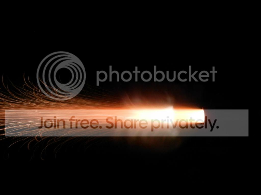

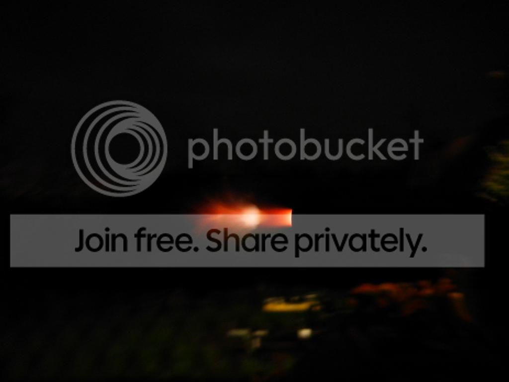

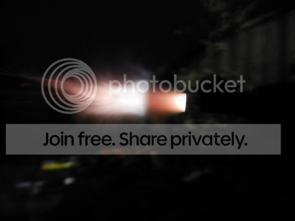

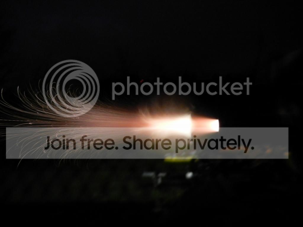

I decided to test the various primers I had on hand to see if there was a difference. I want the"hottest" primer I can find.
I loaded the primers in 38Spl cases and shot them (no powder or bullet) in a 4" revolver.

I took the pictures because I knew how to do it.
I am not so sure I know how to interpret them.
I think I am impressed with the white hot vs red hot and big blast vs small blast. I took 5 pictures of each primer. What you see is indicative of that primer.
The Remington BR and the CCI magnum appear to be the hottest, and Winchester is hot, too. Winchester load ball powder in their ammo.
Remington ran our American Lake City Army Ammunition Plant from 1941 until 1982 and they used the 7 1/2 and 9 1/2 primers to light off the Winchester ball powders loaded in our military ammunition.
The Remington 7 1/2 primer is called the baby flame thrower and is called a bench rest primer and not a magnum primer which seems a little odd.
Bottom line, I use Remington primers to light off all the ball powders I use, if they worked for the military they are good enough for me.
