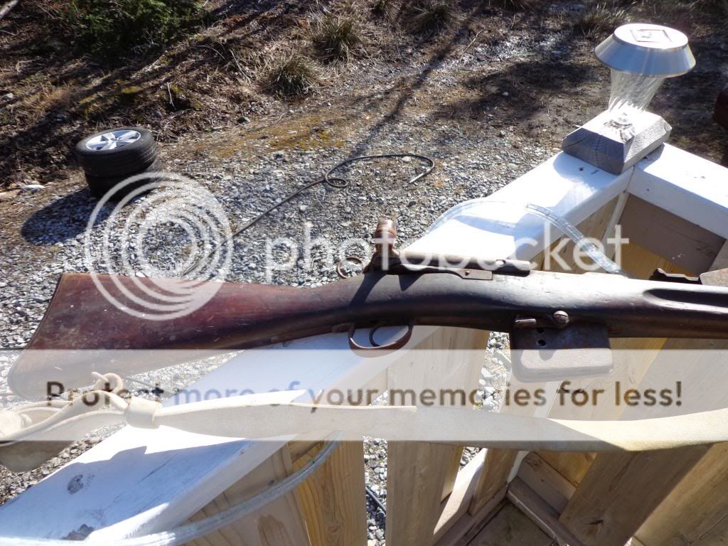

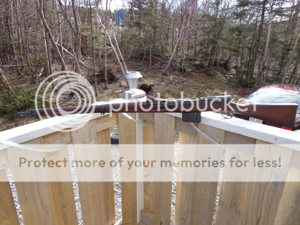

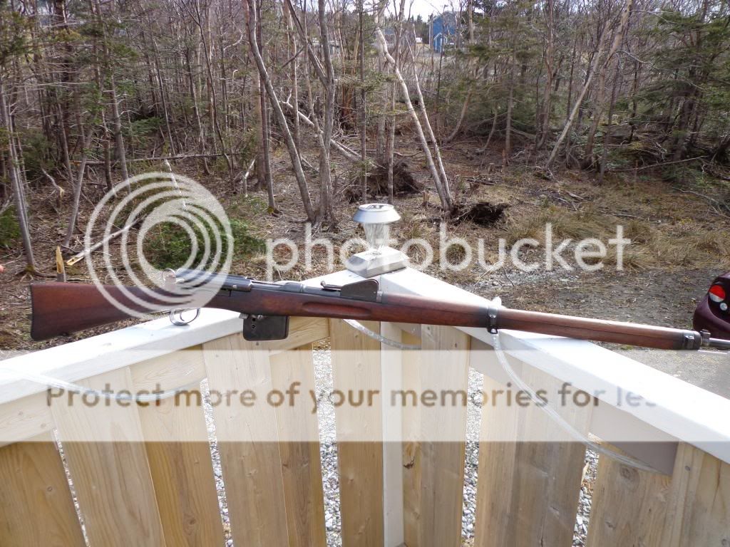

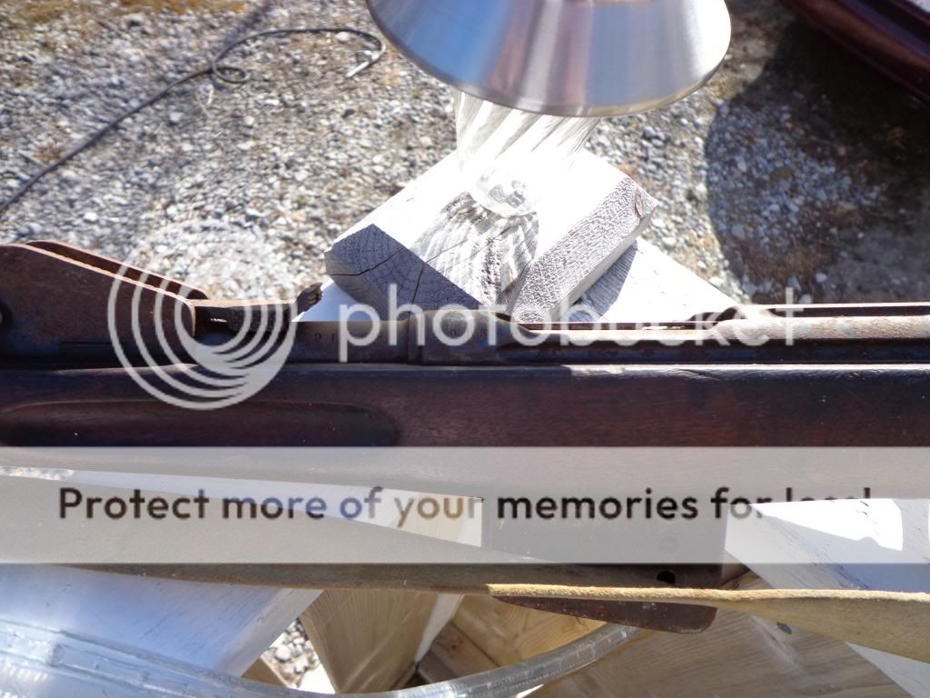

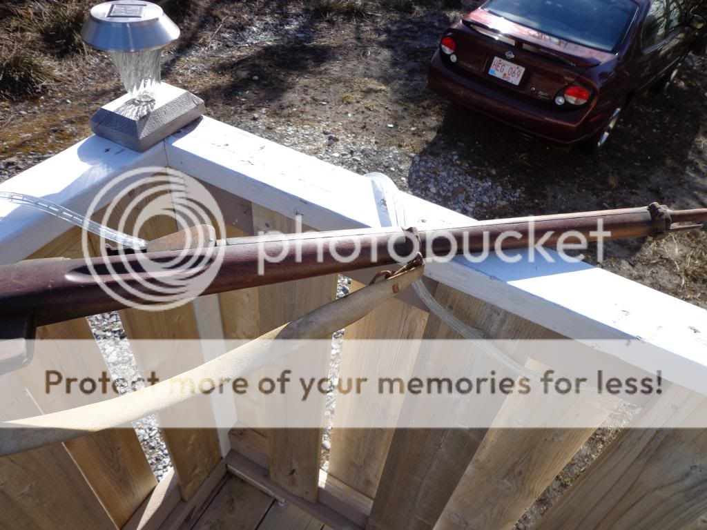

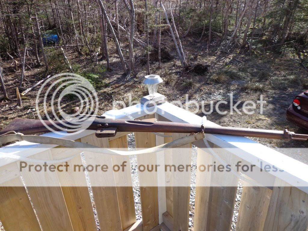

Here are a few pics of the rifle ,im pretty sure its a 1889

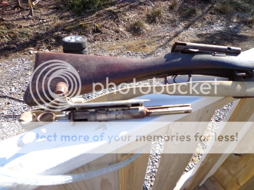

I have it completly dismanteled now ,every part matches includeing the magizine looks like it was never taken apart befour.Pulled my bore snake trough it and the bore is clean and shiney but some of the parts will have to be re blued such as barrel bands ,trigger guard ,and so on
Yes it is definitely a model 1889,now all that remains is to get al the rust cleaned of and getting it to look like the one Badgerdog has posted
