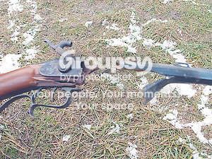

Probably got the load data from a buddy with a Savage. It looks like it was a TC Renagade. It had to be a huge load from the looks of the thing. 100 grs of Bulleyes under a Maxi-bullet?
Derrick W. Edwards’ muzzleloader after it exploded. Pieces of the firearm were found 7 inches deep in the ground. Edwards’ arm was injured, but he was treated and released.
"DELANEY CREEK BOTTOMS — Derrick W. Edwards of Indianapolis was injured when his muzzleloader exploded after he finished deer hunting Sunday in Washington County.
Edwards, 46, suffered a laceration to his left forearm, and was treated and released at Schneck Medical Center in Seymour.
He was injured while attempting to unload his .54-caliber muzzleloader at the end of his hunt.
“Derrick W. Edwards also told investigators that he had loaded the muzzleloader with modern smokeless gunpowder instead of the required black powder,” according to an Indiana Conservation Officers news release. “Conservation officers recovered the firearm from Mr. Edwards and located pieces of the gun driven as deep as 7 inches into the ground at the accident scene.”
Muzzleloaders should always be loaded with black powder or the appropriate substitute. They are not manufactured to withstand the extreme pressures generated from modern smokeless gun powder.
“Mr. Edwards was extremely lucky he didn’t see a deer while hunting this morning,” stated Indiana Conservation Officer Phil Nale in the release. “Had he fired the firearms while shouldered near his head, his injuries could have been much worse.”

"...100 grs of Bullseye..." That'd blow just about any firearm. It's very fast burning handgun powder. 2.7 grains produces 14,600 PSI with a cast .38 Special. This putz likely had well over 100,000 PSI.
+1
If contained in a cartridge even half that would be truly scary load. While a muzzleloader might not allow the pressure to build up to as high a level still the results would be disastrous.
