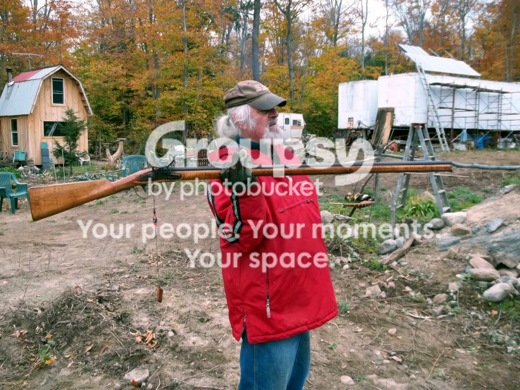

I have an old, original Belgian .625 caplock smoothbore Trade musket that I bought in 1960. It has downed every kind of small game with both shot and patched round ball. It is quite accurate out to 50-70 yds with a patched round ball.
Another friend has a flintlock smoothbore Trade musket that takes a .600 patched round ball. It is quite accurate. The target photo is 2 shots off hand at 50 yds.

Thanks for the pics! Those are sweet looking guns. I definitely enjoyed the flinter (as that is something I am interested in getting). Thanks again!
