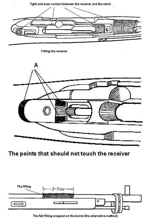

This is how sniper models were set up. This is not my original picture; not sure whose it is. Seems to be in the public domain now.
http://www.smith-sights.com/accurizing-the-mosin-nagant-a-year-later.php
If interested, please stop at the above link. The article comes from long study of both Russian and Finnish accurizing techniques.
